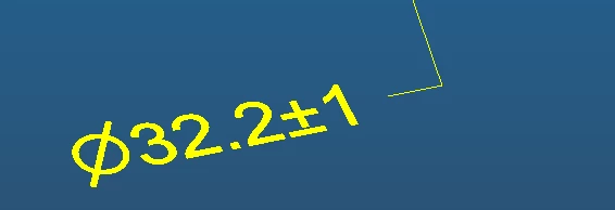

Hi everyone,
I’m working with the team in charge to move to MBE, and I’ve run into a challenge I hope someone can help with.

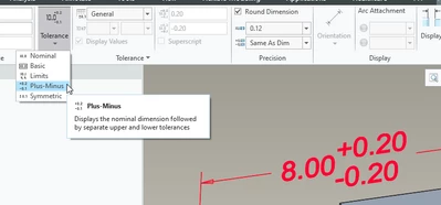

I’m trying to remove the general linear tolerances that appear on every part (see attachment 1). I experimented with setting the "tol_Display" option to "no", which does remove the general tolerances, but unfortunately, it also hides all the local tolerances on features of size (see attachment 2 and 3).
Has anyone found a way to remove just the general linear tolerances while keeping the local ones visible?
I’ve attached a reference image to show what I’m working with. Any tips, workarounds, or settings I might have missed would be greatly appreciated!

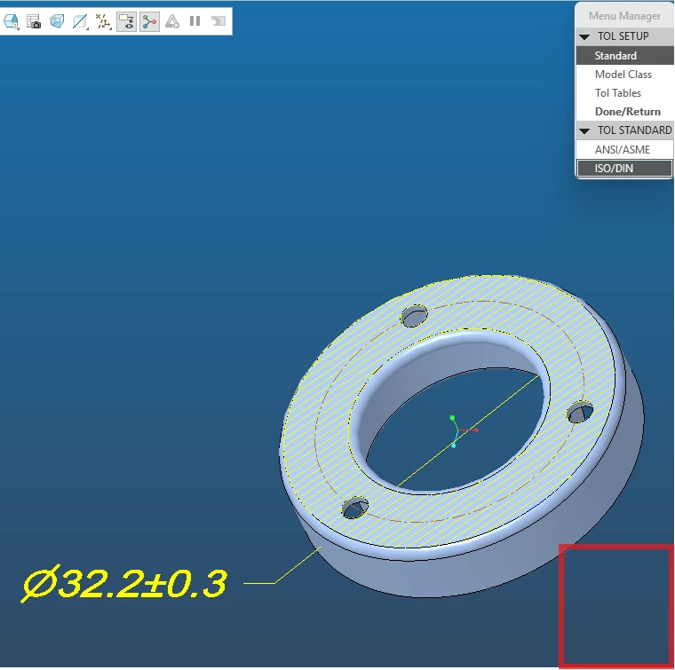

Van_AG
Aug 22, 2025 10:02 AM UTC
Set config option tolerance_standard to iso
For existing models and model templates set
File > Prepare > Model Properties > Tolerancing Standard > Standard > ISO/DIN
9-Granite
Aug 22, 2025 5:14 PM UTC
I tried the option you mentioned, and it successfully achieves the intended result (see attachment). However, since we are currently working on the project to transition our company to a Model-Based Enterprise (MBE), we primarily use models based on the ASME standard, though we also incorporate models aligned with ISO GPS. As part of this initiative, it is a requirement to manage the dimensioning and tolerancing system also represented within the 3D model. Therefore, this solution would conflict with that requirement.

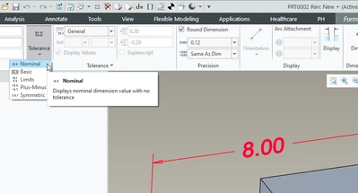

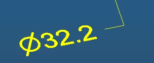

File > Prepare > [Detailing Section] Detail Options - CHANGE:
default_tolerance_mode: nominal
This will set the default tolerance to nominal, so when you place the dimensions, they will have no tolerance by default:
Only after you've changed it to, say plus-minus, the tolerance will appear. You can then select your tolerance table or set manual tolerance values:
Hope this is what you are looking for. If so, you can apply this setting in your speciffic template file - you can then select if for specific purpose only.

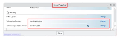

From the dimensions, I guess that you are using a Metric system for Dimensioning. If so, are you using ISO standards for General Tolerances? The general tolerances shown in pic [1] appears only when set to ANSI Standard.
You need to set the Tolerance Standard to ISO for it to disappear. Refer picture below.
