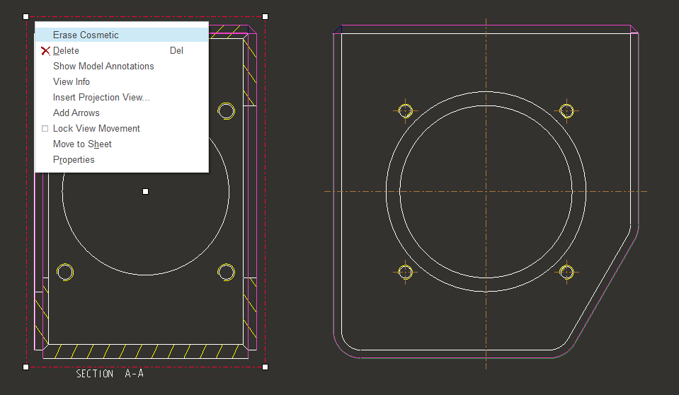

November 28, 2014
try right click on the view, and select "erase cosmetic"
January 6, 2015
Fernando Lopes,
Thanks, it's so useful for me. I was searching for this command.

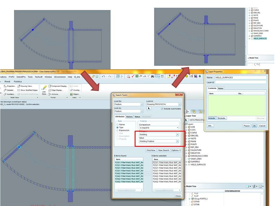

July 22, 2016
Hi all,
I use WF 5 and in the case you have a section with weld feature, the only manner to to hide them is to create a layer with the welding feature inside and then hide the layer referred with that particular view.
Bye
July 22, 2016
Sorry, in the photo I've searched for "welding feature". It works but if you hide the feature I can't visualize the welding note.
You have to search for "Fillet weld".
