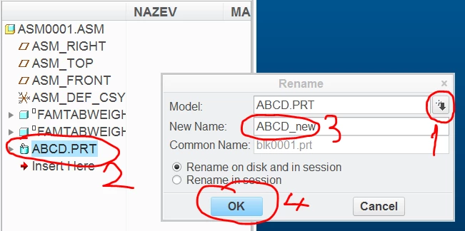

in Creo 2.0 in Assembly mode you can:
  • click File > Manage File > Rename
  • now you can use following dialog box to rename bulk item
