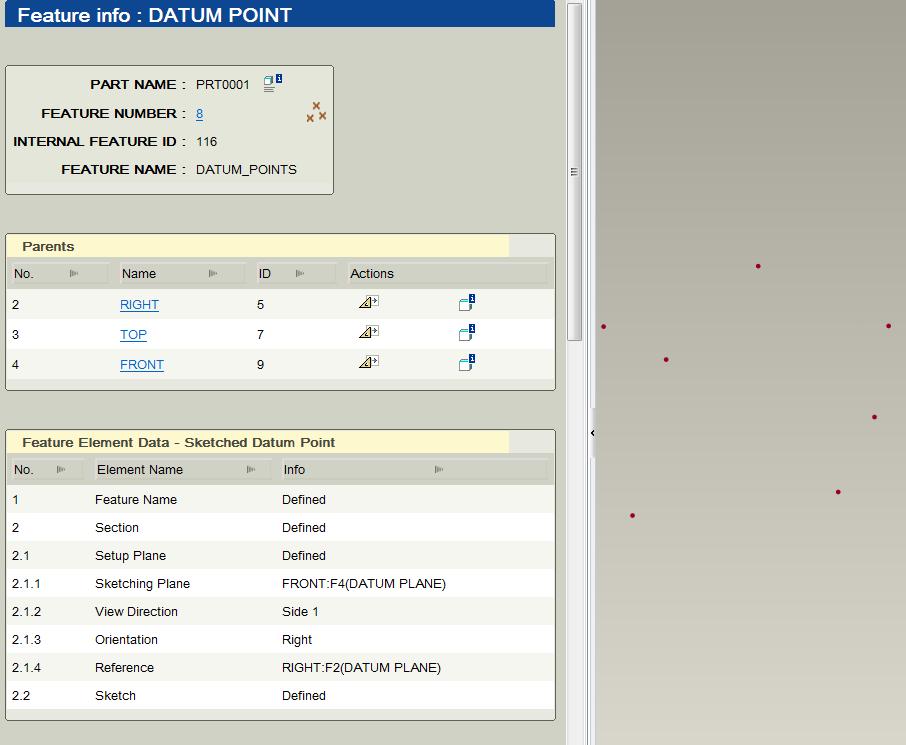

Here is a screenshot of the feature info:
If it created a different feature for each point you could rename them individually, but I don't see anywhere to specify a single point. Even when you try to select one of the points they all select.

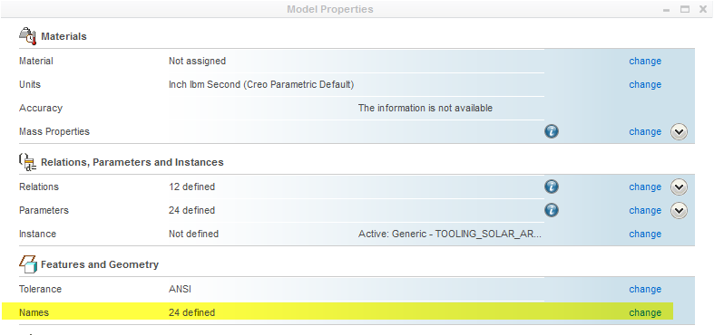

With your version, go to File>Properties>Names. Look to the right of "Names" for the word "change", click this for a list of the datum points to be renamed.

In Creo parametric, you can rename the GEOM PNTS in the model properties window.
