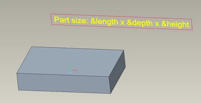

Oct 4, 2022 10:34 AM UTC
One method is to name the dimensions you want to use in a relation. In this example I have named the driving dimensions of the box to height, depth, and length. You can then use those names as parameters in notes or relations. Creo 7 model enclosed for reference.
See this article for details on protocol:
https://www.ptc.com/en/support/article/CS313862
Oct 4, 2022 2:07 PM UTC
I understand the part where you give dimension specific names to better understand their function. But how I can translate this into using them to drive the naming of the local_description parameter, I don't fully understand.
Luckily the answer above did exactly what I intended.
