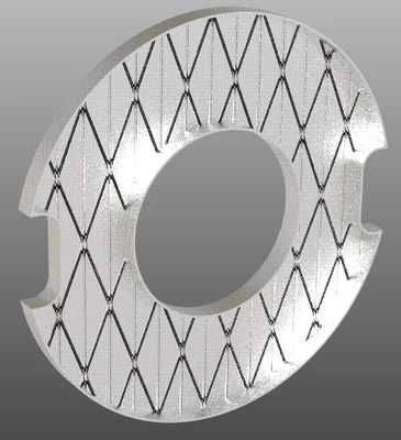

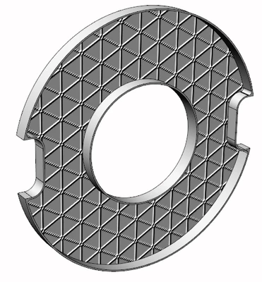

I am having the same issue. It was not an issue with Creo 5, it only started behaving this way when I upgraded to version 10.
I receive no error messages when scaling bump maps. All looks fine in the normal shaded display with "Show textures on shaded model" enabled.
Below area a couple of images of a model with a simple bump map applied to a surface. The top is the normal shaded display, showing the desired bump map scaling. The lower image is the same model in Render Studio, showing the bump map scaling being ignored:
