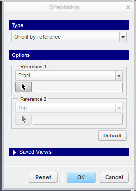

Making the selection from the search area will open the orientation dialog box.

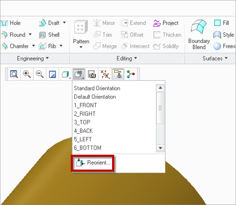

It is under the Named Views Pull down menu in the floating view toolbar in the top of the modeling area.
Answer
January 30, 2014
January 30, 2014
It's also under the same on the "View" tab in the orientation section.
