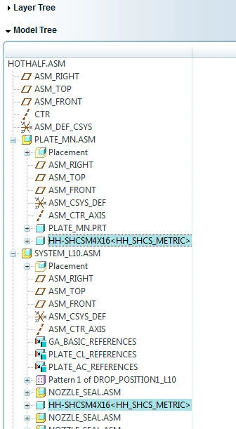

I have some dificulties into a repeat region to exclude some components that were already published in other BOM table.
From begining I want to mention that I have just proe (no PDM).
On the attaced picture I have an assembly that is used in a drawing and based on thsi asembly I have a repeat region.
My dificulty is that the HH-SHCSM4.... that is used in in SYSTEM_L10 was already published in a BOM and I don't want to be shown in repeat region for HOTHALF model.
As you can see both models HH-SHCSM4 are at the same level, but I don't want to see the screw from SYSTEM_L10 in HOTHALF repeat region.
I don't want to be exluded manually, what I would like is to add a filter or rule that will not bring any component that is assembled in System_L10 into HOTHALF BOM Table.
Is it possible to do this?
thx,
CC

I am not sure to well understand your query but:
Repeat Region->Attributes->Flat (not Recursive) will allow you to only show the components of your assembly's top level.
WF5 + Windchill = we still use repeat regions in our drawings as we print them for our subcontractors and customers.
