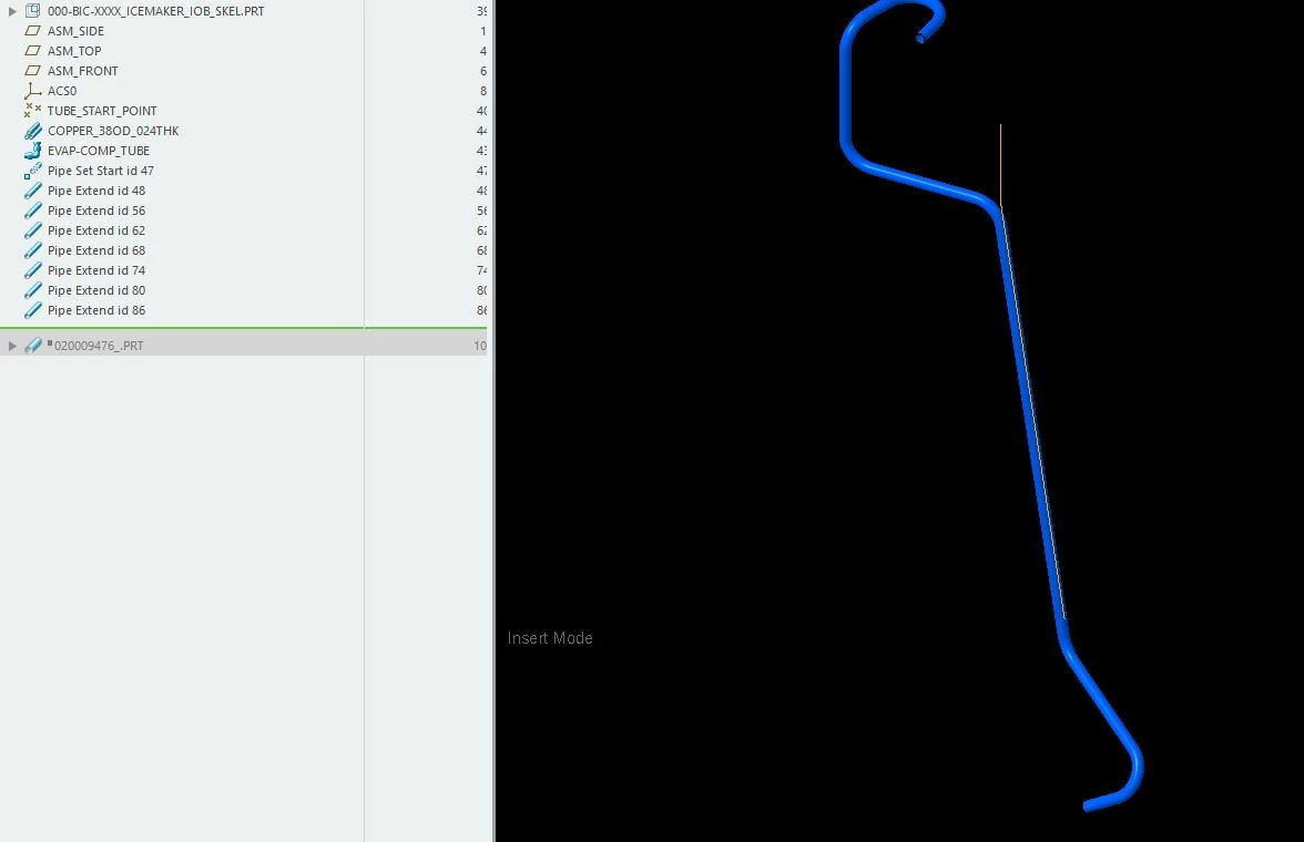

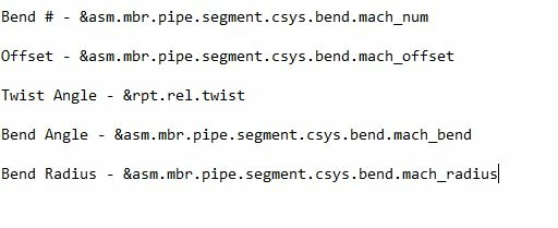

Unable to create a repeat region bend table for the piping assembly. Refer attached snap for the repeat region syntax.  Please support.

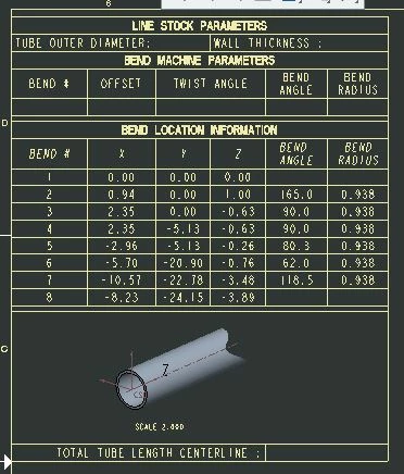

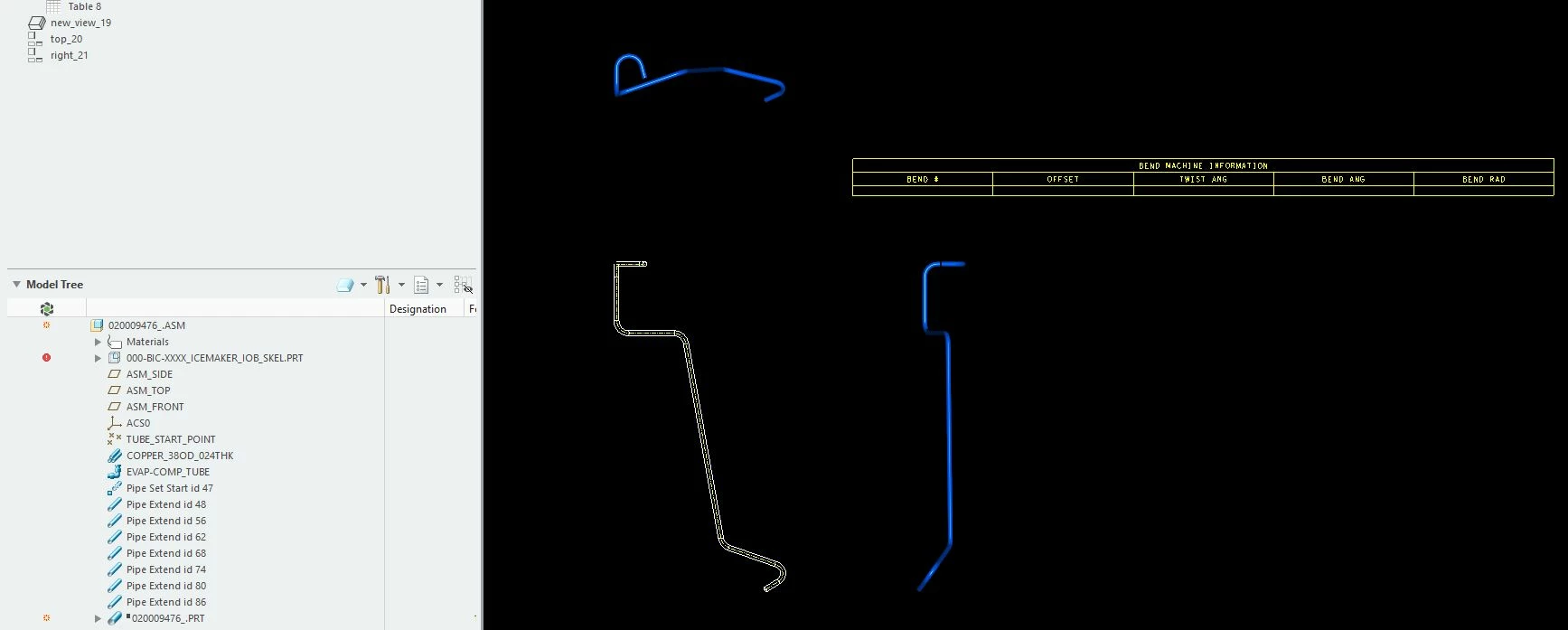

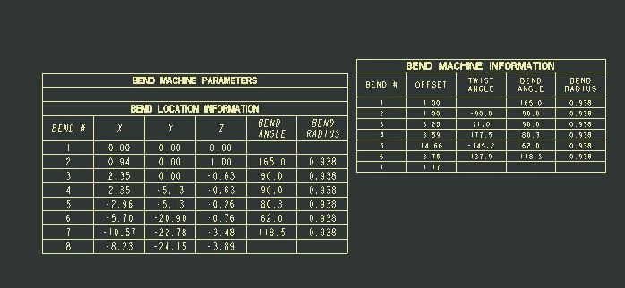

I would like to combine Bend Table and Bend Location table into single table as per image.
But for some reason the machine bend values are not appearing in the combine table even though it has same repeat region index. pls support
