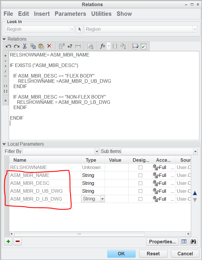

I have Repeat Region Relations that work in one drawing table but if I put that table in another drawing of the same model, the relations no longer work. Here's the relations:
RELSHOWNAME= ASM_MBR_NAME
IF EXISTS ("ASM_MBR_DESC")
   IF ASM_MBR_DESC == "FLEX BODY"
       RELSHOWNAME =ASM_MBR_D_UB_DWG
   ENDIF
   IF ASM_MBR_DESC == "NON-FLEX BODY"
      RELSHOWNAME = ASM_MBR_D_LB_DWG
   ENDIF
ENDIF
If my new table has a column with ASM_MBR_D_LB_DWG or ASM_MBR_D_UB_DWG the relations work, but if I remove the columns, the relations quit working and I see this in the message window: There are errors regenerating repeat region relations.
Anyone know what's going on here??

I'm no repeat region relations expert, but are those two parameters present at the bottom of the relations window?  If not, add them and see if that does it.
I remember trying to add a relation that substituted A/R for the qty on bulk items and I had to manually add parameters in the relations window, even repeat region parameter like rpt_qty. See this thread:
Bulk Item Qty in Repeat Region
March 3, 2016
if I add those columns, the parameters are added to the relations parameters as type unknown, but the relations work as intended. If I then remove those columns, the parameters in the relations editor are gone as well. If I create the parameters in the relations editor, as type string, they remain type string and do not change with the relations, but they do appear in the table. I guess I forgot to mention that when the relations do not work, the two table cells I'm trying to change with conditional statements are empty.

Doug Schaefer‌ is correct, the parameters referenced in your relations need to be listed in the parameters section.  (Remember this Doug: Re: Bulk Item Qty in Repeat Region)
The required parameters will automatically be added to the repeat region parameters section  if you add them to one of the repeat region columns (like MartinHanak‌ mentioned), or you can just manually add them to the repeat region parameters section yourself.  They do NOT need to be in a (hidden) column of the table.
Finally, "IF EXISTS" does work in repeat region relations (and this is the only place it works).  See this discussion for a sample: Relations in drawing BOM
Let me know if you need screenshots demonstrating all of this.

March 5, 2016
Bingo.
By the way, don't get hung up on the parameter type.  You have to pick one when creating the repeat region parameters, but after actually being executed on an assembly,they will all change to unknown.  This is because during execution they could actually change type.  For example, one model could have a parameter defined as a string and the next model could have it defined as a real number.  The repeat region parameter types will automatically switch back and forth to match the model's types.  (Which can cause issues if you're using a type specific function.)
