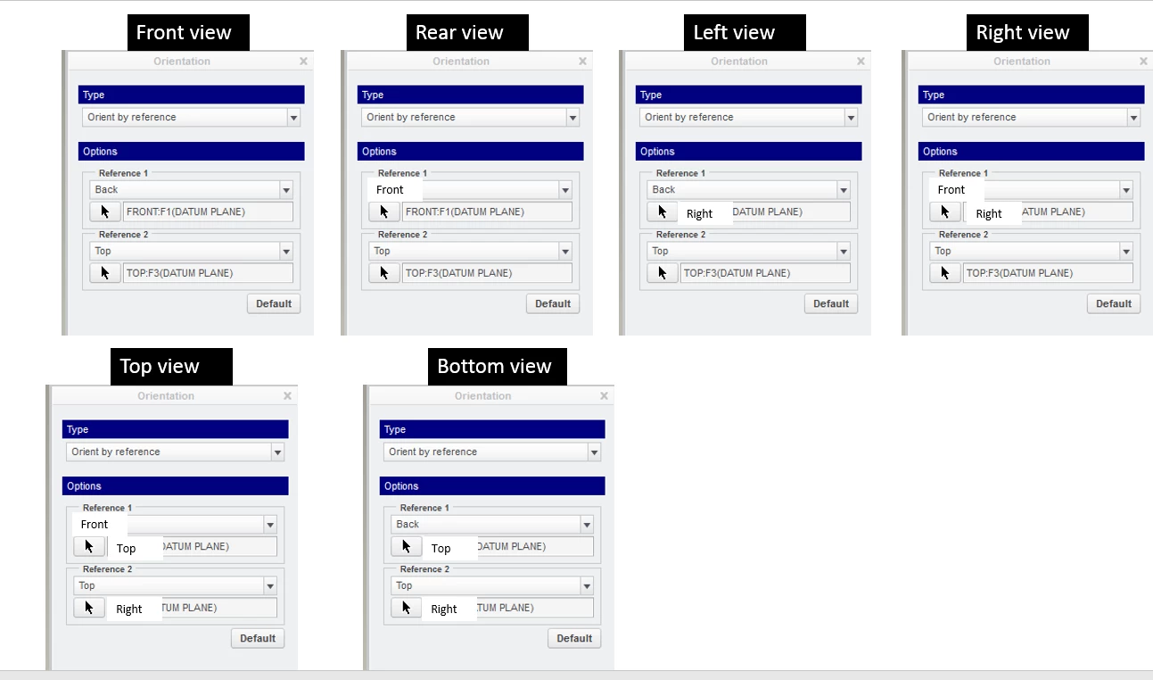

HI,
   required create basic view orientation mapkey
View names : FRONT, REAR, LEFT,RIGHT,TOP,BOTTOM,ISOMETRIC
15 replies
March 21, 2018
firstly find a way how to do it manually. When you will find manual procedure you can automate it using mapkey. It's up to you, nobody will help you.
dg-21-VisitorAuthor
March 22, 2018
i know the manual way. my problem is this method doing with mapkey its not working properly.
i tried to select planes via search comment and manual model tree selection while recording mapkey.
March 21, 2018

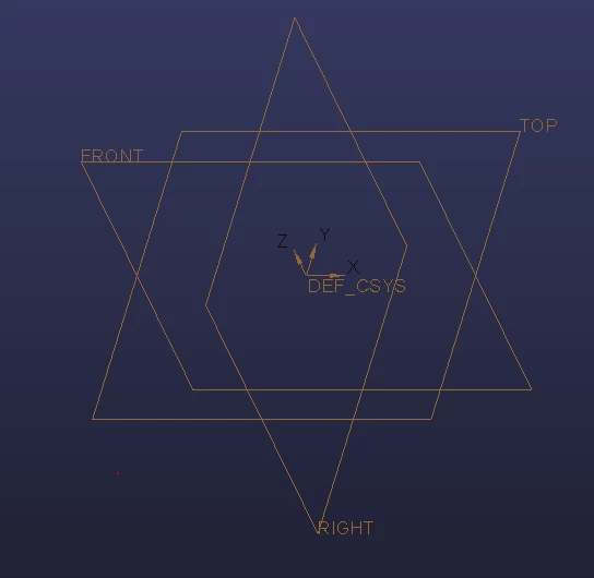

Here are mapkeys for FRONT, BACK, LEFT, RIGHT, BOTTOM, TOP, and ISO.
Run the "add_all_views" mapkey to add them all at the same time. The ISO view isn't a true isometric view. It's a fairly random orientation.
You will need to have the 3 datums called FRONT, TOP, RIGHT for these to work.
Dan N.
