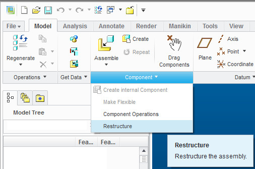

I would like to create an utility for restructuring parts. the utility should simple allow selection of several parts
and move it to new/existing sub assembly.
While searching through the misc documentation  i couldn't find any information about it.
Does any of you have an experience with the following ? any ideas ?

There are already one command that does exactly what you describe:
How this new utility will be different?
July 25, 2016
Correct. Restructure does exactly what you describe.
