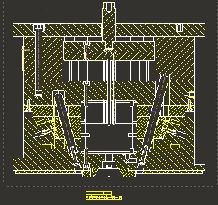

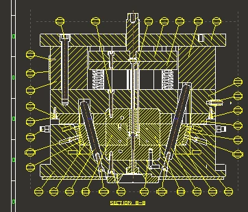

I need to create 2 sheets. The 1st & 2nd sheet are extremely similar, just that we delete some elements from the views of the 2nd sheet.
For this we copy the 1st sheet and then edit the 2nd sheet.
But this leads to the balloons getting deleted as well.
Is there any way in which we can keep the balloons in the 2nd sheet for the items which are not deleted??
Manually doing it all over again for 2nd sheet takes upto 3-4 hrs.

May 10, 2019
I change the represntation which causes the balloons to disappear.
StephenW
May 9, 2019
If the sheet you are copying has the BOM table on it, the balloons will remain but will reference the BOM that was copied with that sheet and if you delete that copied BOM, you lose those balloons.
If the BOM table is on another sheet, you lose the balloons.
May 10, 2019
Yeah but when i change the represntation of each view i tend to lose all the balloons. Is there any way in which i can retain the balloons?
