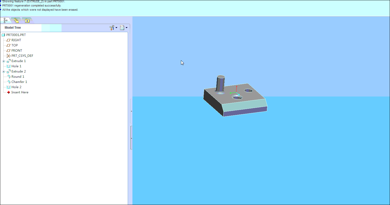

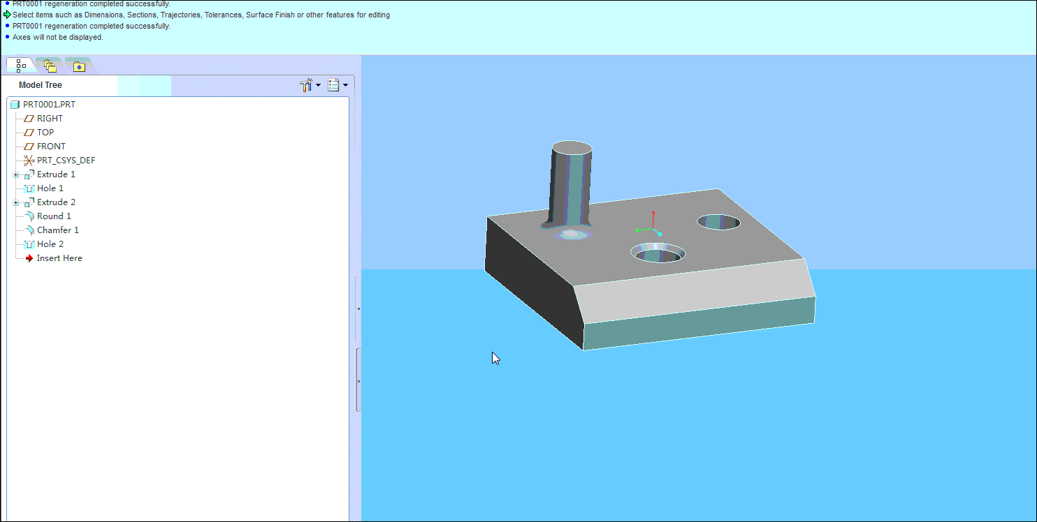

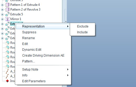

December 20, 2013
click the picturedfg.gifalso you can use the find tool to look for the exclude features,and click this pictureone.gifIt's very useful! I love the find tool.
