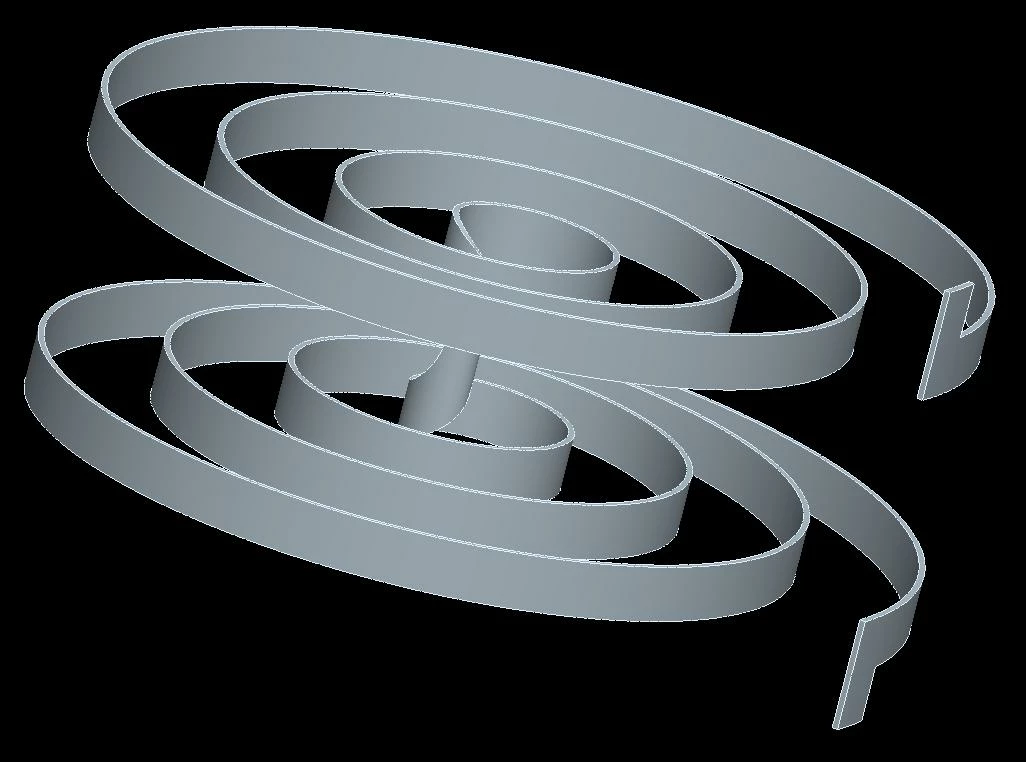

    Is this something like what you want? I whipped this up in about 10min. It doesn't have notches, but you can see in it's developed length, it has a smooth taper from the tabs to a full radius.
    January 11, 2012
    It is quite similar. However, I'm wondering what that helical tab in the middle is for. What I need is basically a piece of paper laid down, then rolled up along one of the edges. It needs to be done quite tightly with minimal clearance. But yes, the shape is most certainly there and looks like a good start.
    Patriot_1776
    January 11, 2012
    I did that just for fun to see what can be done with a particular technique I have. If you need both a flat and a coiled version, you can do one part as an instance of the other, in your case it sounds like the coiled version would be the instance of the flat version. That part took a total of 7 features excluding the initial datum planes and CS. So, it's actually a pretty simple technique.

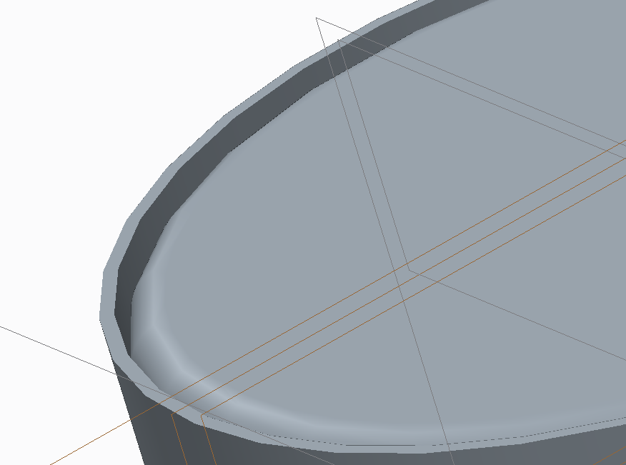

    Sorry, I should have been more precise in my question. I have two problems. This is my first.
    I need to "fold" the circular ridge onto the rounded cap (basically crimp the cap into place with the circular ridge). I could do this manually, but I'm sure there must be an easier way.

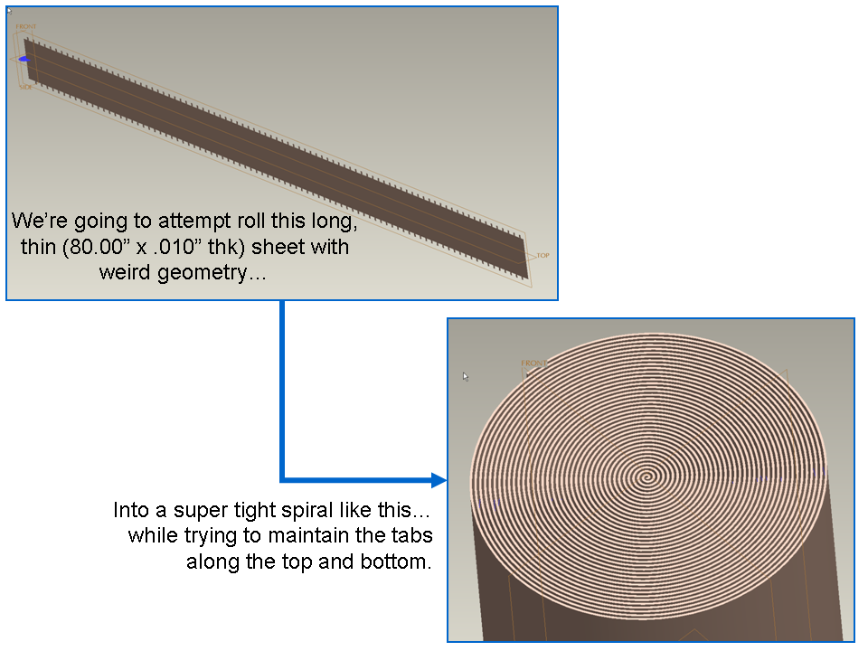

    The short answer here is: Yes, well, sort of... it depends! I have gotten as far as I can go... with is 98% of the way to a solution. Hopefully once I post this, the community at large can come together and get us the last 2% of the way there.
    The longer and thinner your sheet is, the harder it will be to roll it up into a cylinder. You're going to eventually hit an accuracy wall where Pro/E just can't go any further. Therefore, the first step is to perform a maneuver I've never had to do in almost 25 years of practical Pro/ENGINEER experience... RESET the lower accuracy boundary.
    I'd love to get a show of hands to see how many people even knew that was possible!
    In fact, in addition to resetting the lower accuracy boundary, we need to set several other rarely used switches before I can even begin this tutorial. We're going to be making something that looks like the image below... and it's pretty intensive and nasty although it looks deceptively simple.

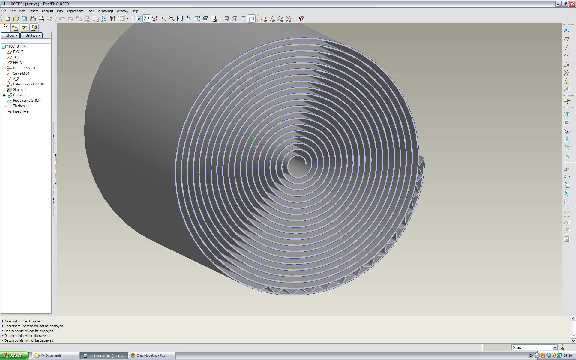

    Brian - I'm extremely lucky to come across this thread as I am trying to acheive something simular to this. Although I keep getting stuck at step #4 because my geometries intersect
    Anyhow I have manage to create a simple method to create a tightly rolled cylinder.....
    1 - Simply create a datum curve with a cylindical equation. set the IR to something like 5mm and OR to 50mm, and set number of layers to 20. This will give you a tight spiral......
    2 - Next select INSERT > SWEEP > PROTRUSION
    3 - Now sketch a long thin rectangle i.e. 100mm x 0.5mm....now tick 'finish and there you go!!
    SEE IMAGE ATTACHED
    The only addtion to this which I cannot achieve is the zig-zag pattern I am trying to create which will follow the datum curve all the way to the centre. It can be done with thousands of Datum Points, but there must be an easier WAY?!! This is why I started searching for Spinal bend methods as I though it might be do able If i started with a flat sheet with a zig-zag surface already in place....?

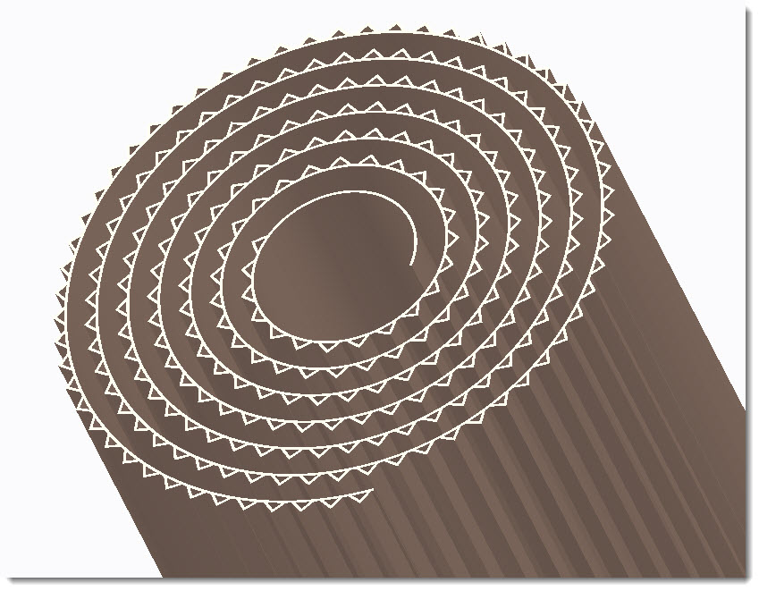

    I've seen your screenshot and I see what you're trying to do. I agree that an equation to create the spiral is the best way to go. The tutorial used something more complex because the user needed a spiral with all these crazy cuts patterned along the length. In your case, a simple spiral equation works well.
    To create the zig-zag, there are several things I would try. First, try patterning along a curve. Use the curve created from the equation to replicate the zig-zag geometry along the entire spiral. You can choose the number of zig-zags or the spacing between them (and let Creo make as many as it can at the given spacing).
    If this doesn't work... you might try patterning the zig-zags as enclosed SURFACE features. You will not get any self-intersection errors this way. Once the pattern is created, SOLIDIFY the surfaces to make them solid. This could be dicey and you may need to crank the accuracy down to a smaller value to make it work- but there's a chance this technique will work as long as your spiral isn't really, really tight (like the one in my tutorial).
    The last thing you might try would be to make a surface from your spiral equation. Instead of making a solid, make it a surface (like I did in the tutorial). Drop a point on the surface at the very edge... it has to be an "on surface" point but it can lie on the edge. Then, use Flatten Quit to make a flat surface. Next, create your zig-zags using the flat quilt as a reference. Make these solid extrusions. Allow them to extrude down the length of the quilt. Once you've patterned your zig-zag down the length of the surface, use Thicken to give the original surface a thickness and turn it into a solid. Now you'll have a long, thin solid with the zig-zags running down the length of them. Finally, use Solid Bend (renamed Flatten Quilt Deformation in Creo 2) to bend the solid back into it's coiled shape.
    This last technique definitely works. I've tried it (at least in Creo 2)... here's what it looks like:
    I realize I put the zig-zags on the wrong side but that should be easy to fix. I've included a model for you to examine. It's been done using Creo 2. I didn't catch which version of Pro/E or Creo you were using. If it's something earlier than 5, let me know.

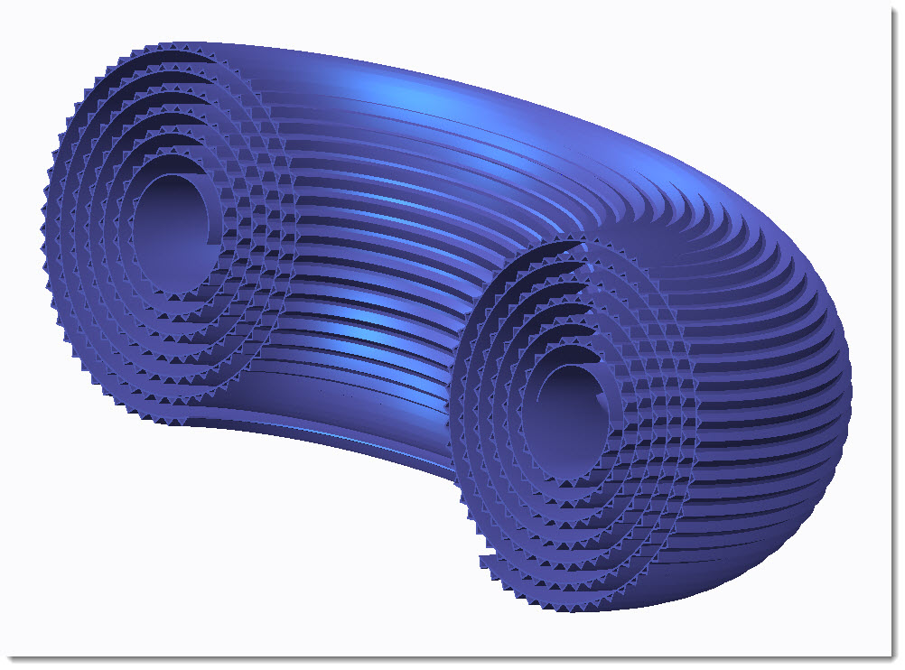

    Just for the heck of it... here's an example of something else you can do...
    You can use your imagination... it's possible to make some crazy shapes with Creo.
