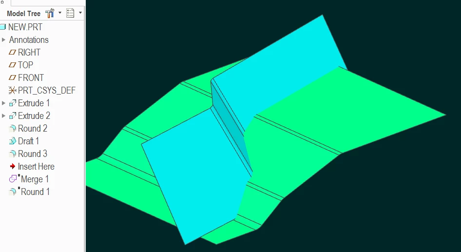

You can get a similar result in a different way.  Surfaces to be "filleted":

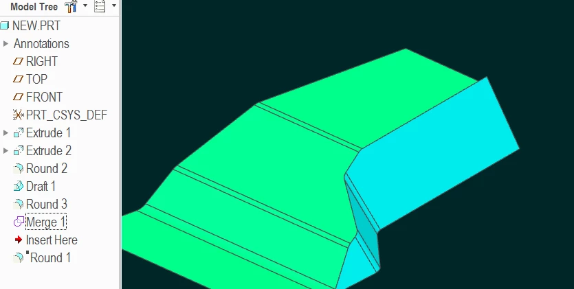

by first merging your surfaces:

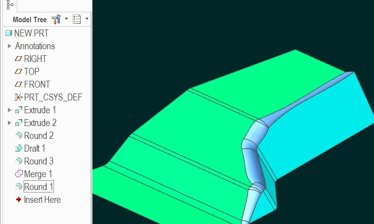

thus creating the sharp edge, which you can then round over:
