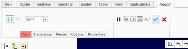

    February 27, 2013
    Patrick,
    [cid:image002.png@01CE14E3.230E1420]Yes, It is possible to control the preview options while creating features in Creo Parametric-2. You may need to use below three icons (No review, Attached, un-attached).
    [cid:image003.jpg@01CE14E3.230E1420]
