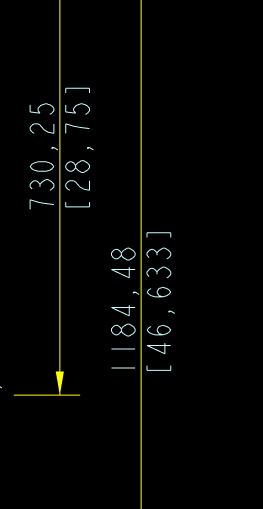

while working on the drawing , the dimensions it shows like 4 precision ,i changed it upto 2 places .
But after closing and open it again ,all the dimension tolerance shown as before .
Please help.

December 16, 2014
please see the image as i again make it round by properties ,it appear again.
Manish

That is dual dimensions rather than tolerance.
This is normally set in the detail.dtl settings (drawing settings file).
It is a global setting.
See dual_digits_diff
