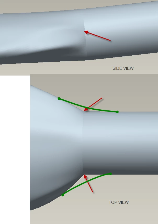

Having trouble adding a round (GREEN LINES) between 2 swept blends connected together (RED ARROWS) as seen in the attached figure. the swept blend on the right is a curved cylinder, and the swept blend on the right is made from irregular splines along the same curve. any suggestiosn?
February 29, 2012
Looks like the round goes from concave to convex via. the top view.
February 29, 2012
Project curves on the surfaces of each side to create two boundaries for a boundary blend instead of a round....see if that works.
