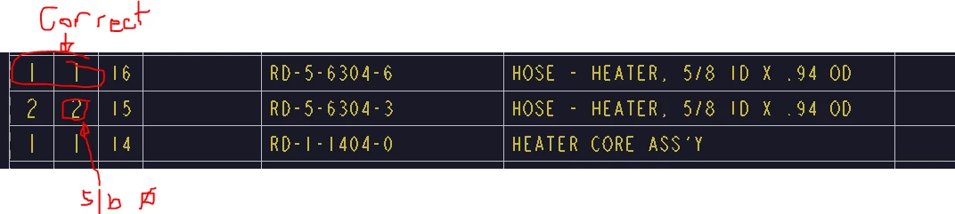

So, I am trying to create a mutiple assembly BOM with rpt.qty in an additional column, selected column model/rep, add the model I want and I get the same quanities for the -1 model as I do for the -0 model. I have tried this multiple times to no avail. I have replaced the border a few times and started from "scratch". Does anyone have any ideas what I may be doing wrong?
Thanks!
Tim

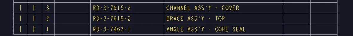

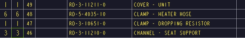

Upon further inspection, it appears that my table seems to take on both assemblies and adding the quantity for the other assembly where it should have a 0 or be empty. For example: both the brace assy and the channel assy should be 0 or blank in the column to the left, as seen below, and cover - unit, clamp - dropping resistor and channel - seat support should all be 0 or blank in the right column, second image below.
[cid:image003.jpg@01CFCC05.63B60610]
[cid:image004.png@01CFCC05.5DBCF0C0]
Tim Helgren
Drafter
Specialty Products
