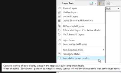

Sometimes I'll be working on an assembly that has some read only hardware in it and Datum Planes for those parts will be visible...
I can hide them in the Layer Tree but it won't save that status because it belongs to the read only part.
Is there not some way I can tell Creo that in this assembly I want to hide those planes?

The best option would be to hide the planes in the fasteners so that they are hidden any time you use them. It sounds like this might not be an option though...
Try this...
  • Access the assembly
  • Hide the part planes in the layer tree of the assembly
  • Adjust the layer tree settings
  • Uncheck "Save status in sub models"
You could also use simplified reps to exclude the fasteners from the assembly. The rep would be saved at the assembly level that you have write access to.

If you uncheck the checkbox for saving status of sub models, you can do what you're asking for. Hide the planes at the assembly level and save the assembly status. With the box unchecked, you won't be prompted to check out the part files.

Are you using WindChill?  If so, for these types of issues, I always change the Action in the Conflicts dialog box to Continue.  This allows the change to be saved to the workspace without checking out the part.  The planes will remain hidden as long as the part is in that workspace.  Also ask that the server version be updated so that you and others don't have to do this every time it is added to a workspace.
