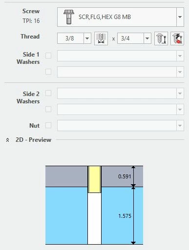

I am trying to make a screwtype for hex head flange screws. We where using screwtype 99 for them, but we have a lot of them so we wanted to make it have it's own screwtype. I was able to copy the screw_01 folder and give it a new number. the issue I am having now is in the 2d preview the head of the screw is not showing10-24-2018 9-52-44 AM.jpg

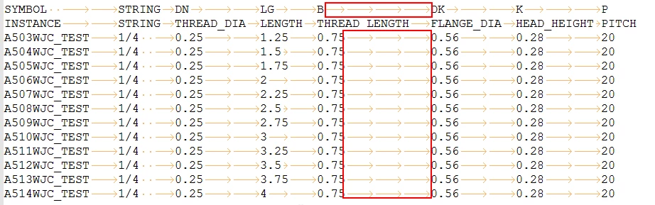

today I had a look at your *.dat file.
It is not possible to add a special screw type like yours.
In your case you have to use the screw type 99.

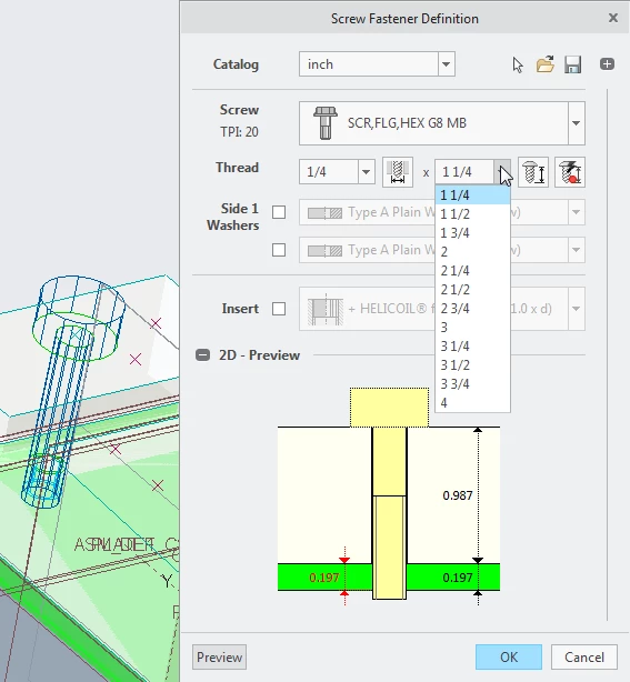

Find attached the corrected *.dat file. These files will show this result:
NOTE: You have to cleanup all your empty tabs. I know this makes it easier to read, but IFX cannot handle this. See the attached *.dat for an example.
It might be helpful in some cases to copy the table (start with the row SYMBOL) to EXCEL, make your changes and copy it back again.
