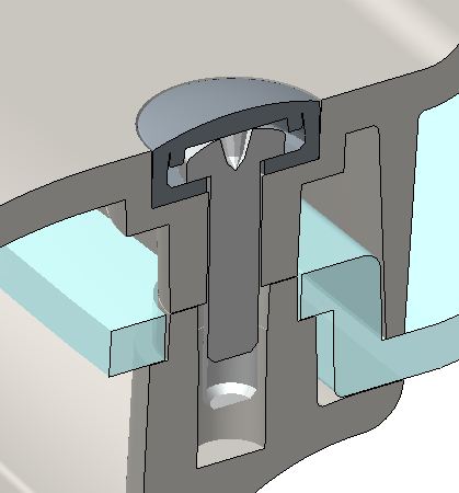

I have some fasteners in my assembly that I replaced with a longer version from the same family table.  I had the section through one of them active when I replaced them. After replacing, the section was no longer active.  I re-activated the section but it still shows the old fastener with the new ghosted as if it were a surface model (see screen shot below).
I tried deactivating and reactivating teh section and regenerating the assembly, no change.
How do I fix this?

Doug, I am seeing what you are saying with a model I am working with right now.
I have these ghost surfaces floating around from features I am tweaking into shape. Very annoying!
I thought I remembered CS saying this was resolved by M060? I am still on M040 and it is a very pervasive problem.
Toggling the cap in by editing the section seems to "regen" the section.

The parts themselves display properly on their own.  No issues with the part family table at all that I can see.  There is no family table in the assy.
The problem eventually resolves itself, but I'm not sure how.  It's as if Creo is storing some visual representation of the cross section and it's not getting updated properly.  The parts are sectioning right but not getting capped right.
It's frustrating to cut a section to check screw engagement, discover you need a longer screw, replace said screw and reactivate the section and at first think that it didn't get resolved.
