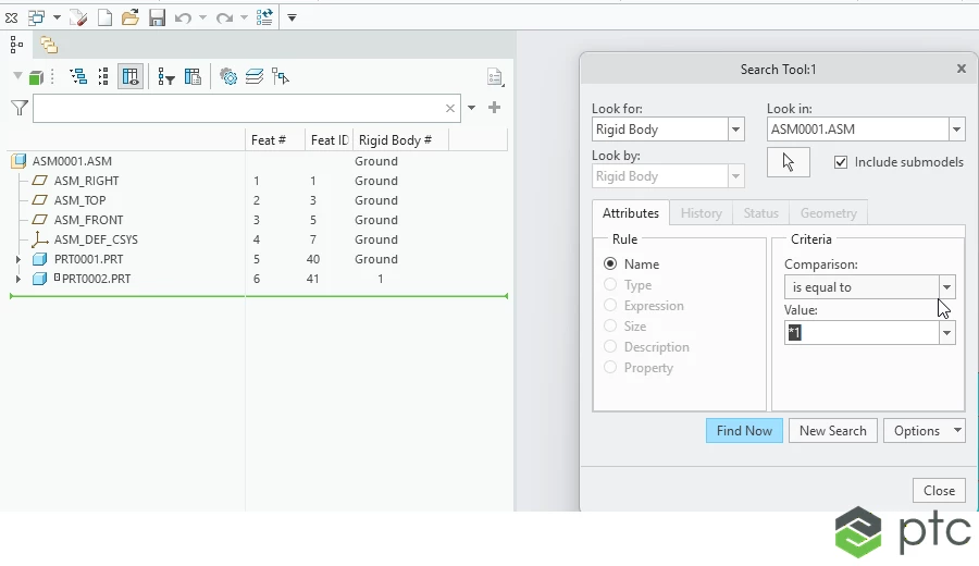

May 5, 2026 10:59 AM UTC
  1. to select all components that belong to the same Rigid Body, you can use the search tool : CTRL+F and then pick the criteria.

6-Contributor
May 5, 2026 11:37 AM UTC
Hi @remy,
Regarding point 1: yes, using the Search Tool I can highlight and visualize all the parts belonging to rigid body 1.
However, I cannot do much with the highlighted result. For example, I cannot create a Simplified Representation from it. If I right-click, there are no useful options available.
Is there a way to convert the highlighted result into an actual selection?
May 6, 2026 7:59 AM UTC
The search tool will display the items found.
Then you need to collect them to your selection buffer with the button in between the columns.
Once you hit Close, the selection will be highlighted in the graphics, in the model tree and at the bottom right, the number of items selected.

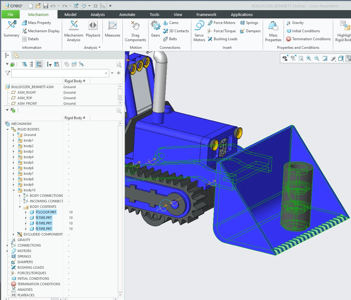

MikeBennett
May 12, 2026 12:39 PM UTC
Hi ​@FB_14460137 ,
The selection buffer will not select the components in the Model Tree, but if you have the Mechanism Tree displayed while in Mechanism Mode ( Applications > Mechanism), the searched body will be selected.
This Mechanism Tree also shows a Rigid Body node including subnodes for Body Connections, Incoming Connections, and Body Contents, where all of the components in that body will be displayed and can be selected together by selecting the first then hold Shift & select the last
