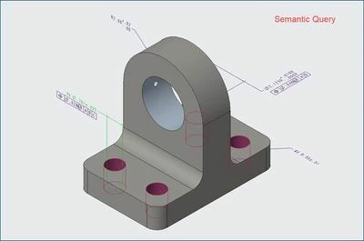

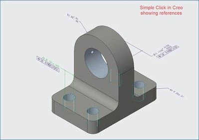

Semantic Highlighting Preference in Model Based Design
While creating a part with Model Based Definition utilizing semantic references, when we select an annotation, the edges and related surfaces highlight, but in a way that’s hard to distinguish edges/surfaces.
When we select “Semantic Query” the highlights are much more obvious and useful.
Looking for a method or setting for making the “Semantic Query”-style highlight for annotations the default behavior (without having to click semantic query first).
Snapshots of the current behavior and desired behavior when selecting annotations that contain semantic references below.
Current behavior upon annotation selection:
Desired behavior upon annotation selection:
(Note: image above shown utilizing semantic query, desire is for that step to not be necessary)

New Creo Parametric Idea posted to request this functionality. Confirmed with support request that this capability does not currently exist. 1024249
Jul 2, 2025 6:12 AM UTC
please ask PTC Support whether mentioned functionality is implemented.
gcmunroe7-BedrockAuthor
7-Bedrock
Jul 7, 2025 8:33 PM UTC
That was our first stop, they recommended posting here.
gcmunroe7-BedrockAuthorAnswer
7-Bedrock
Jul 14, 2025 6:37 PM UTC
