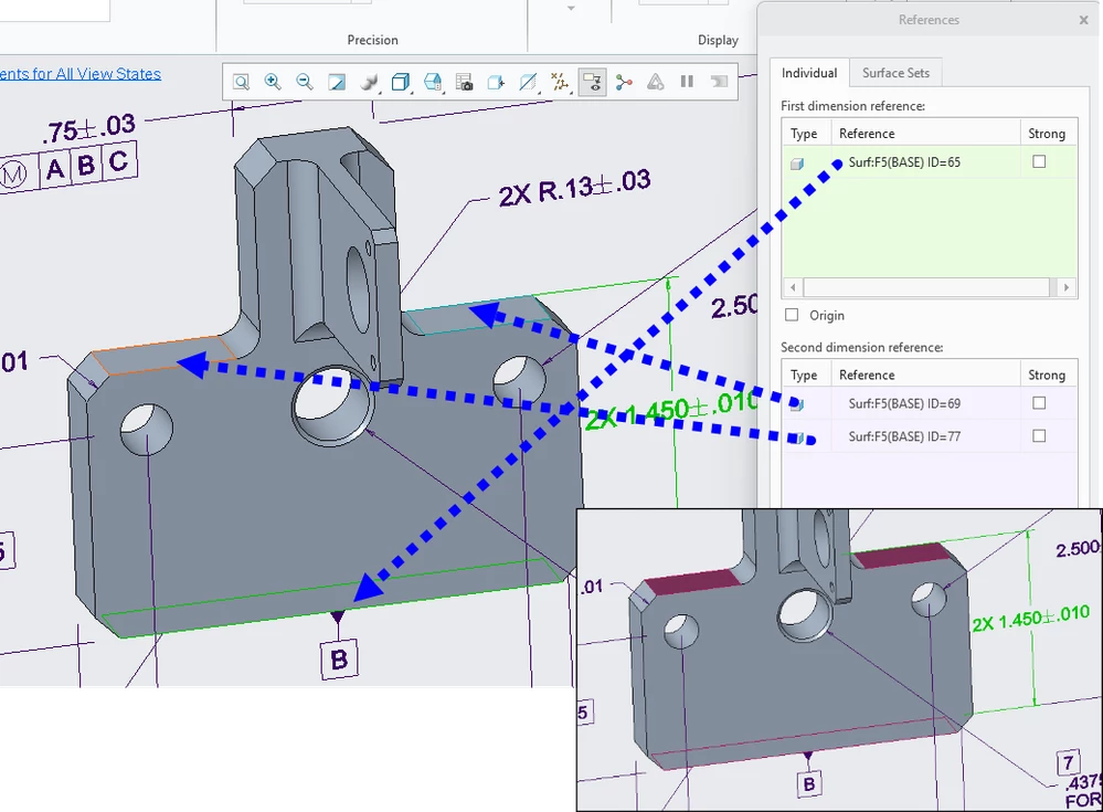

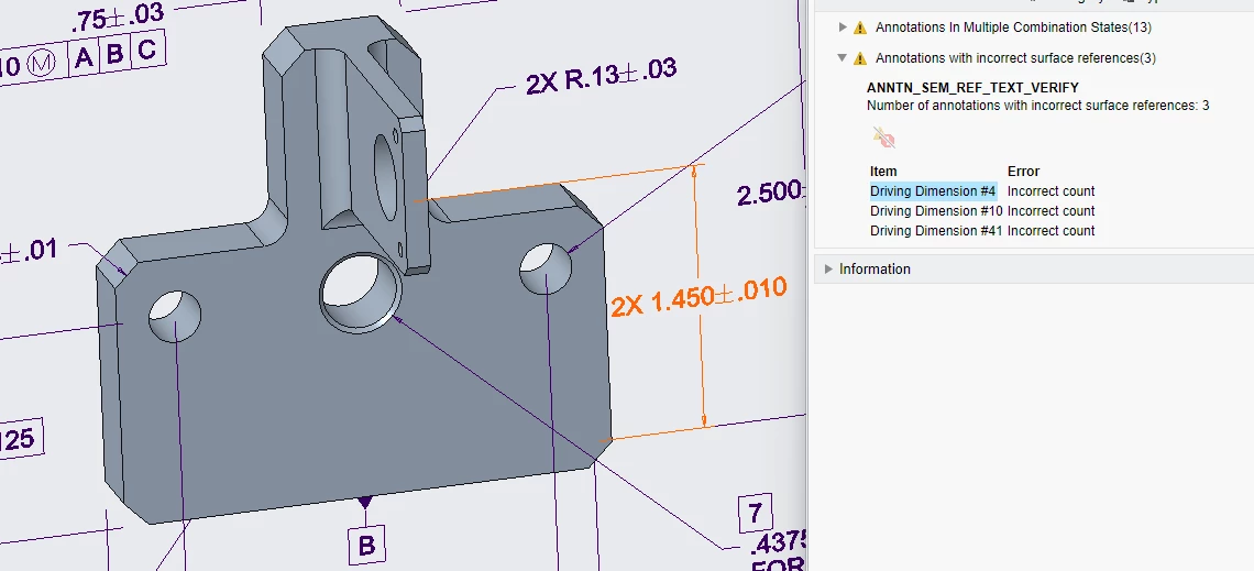

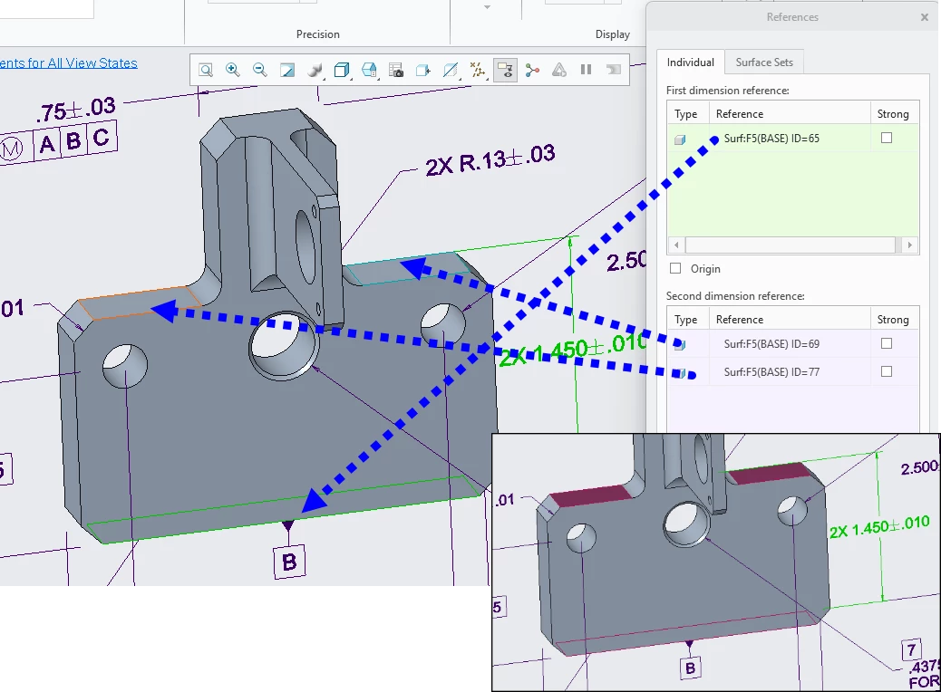

I am using Creo Parametric 10.0.4.0 and performing a Model Check on a part and I am looking at the warning for "Annotations with incorrect surface references" which has the name ANNTN_SEM_REF_TEXT_VERIFY.
It is telling me that I have the incorrect number of annotations with incorrect surface references.  I am trying to indicate that there are two surfaces that are 1.450 away from datum B, so in the references, I have datum B in the "first dimension reference" and then the two surfaces in the "second dimension reference."  So why is Model Check flagging this?  Am I doing it incorrectly?image.pngimage.png

I tried to simulate the case. It works perfectly without any modelcheck error.
Check the following....
  • Angle between the bottom and the highlighted surfaces. (it should be zero)
  • Distance between the two surfaces that are included in the second-dimension reference. This too should be zero.
I see that you are on Creo Parametric 10.0.4.0. I am on Creo 10.0.9.0. Updating might help.

I tested this in 10.0.9.0 and the issue was with the 2X.
When I removed the 2X and replaced it with the continuous feature symbol or "multiple surfaces" under the dimension, modelCHECK had no issues.
I am not strong enough in GD&T to know if this is because of a ruling there or if it is something on the Creo end involving the actual count of how many 1.45" dimensions there are in the model.
In my opinion Creo is Correct.
2X would mean Two Distinct Features.

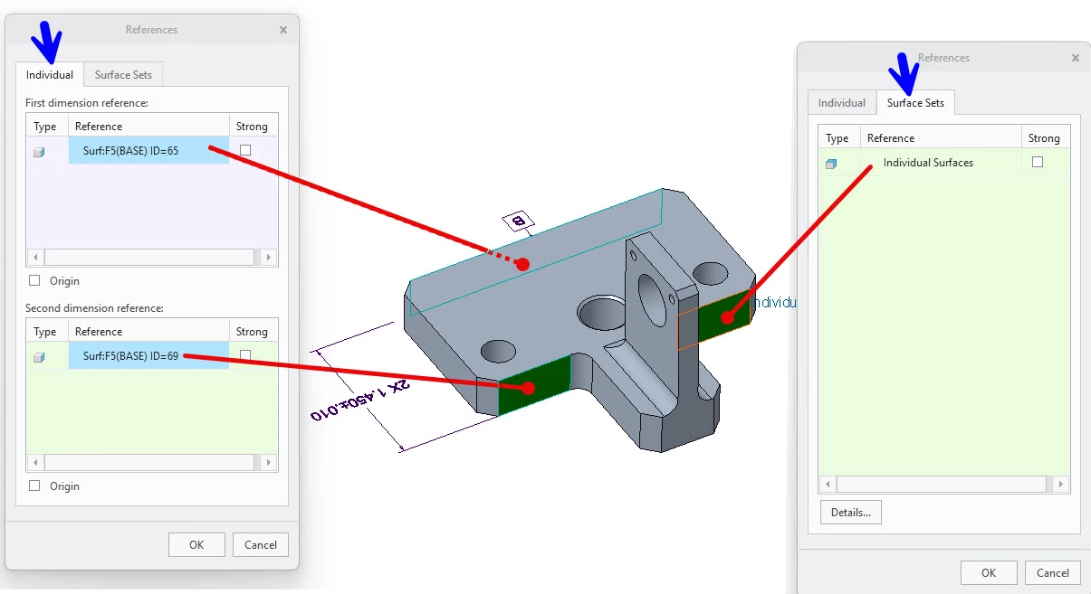

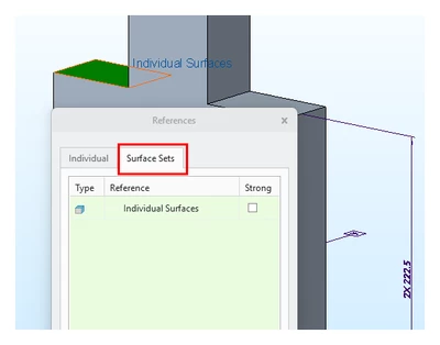

In the design the First surface remains the same and there are two different surfaces for the second surface. You may try and add additional surfaces under Surface Sets. ModelCheck does not return an error.
