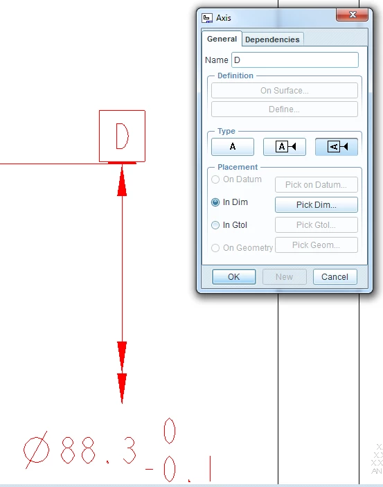

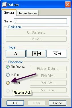

This is the solution that I have used to get what I wanted. It is a good work around because it is basically what we are doing by putting them "in" the dimension.
THE gtol is placed as a free note and then Edit > grouped to the dimension
the datum can then be placed in the GTOL
