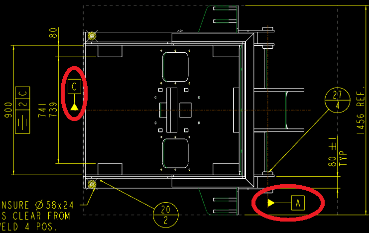

We have a Creo 2.0 drawing containing a number of set datum targets
When we create a PDF using File > Save As > Export the set datum targets disappear.
Anybody know why?

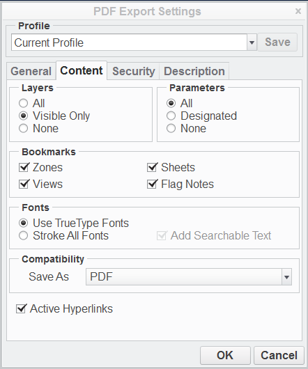

Neal,
maybe layers affect the result. Try to play with settings.
BTW, I use File > Save As > Save a Copy > select *.pdf format to produce PDF file > OK

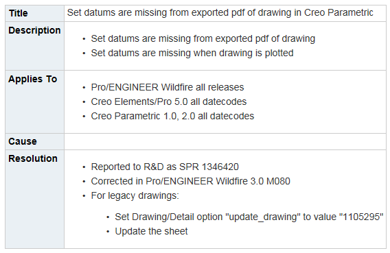

Neal,
I just stumbled across this on PTC's support site: CS175782
Might be worth at least trying the special "update_drawing" value.

thanks to all for your replies...unfortunately this is one of those occurrences where the problem has 'fixed' itself.
The user reported back that it is now working although nothing was changed.
Anyway thanks again...Tom's last suggestion might have something so I'll try that if it comes up again.
