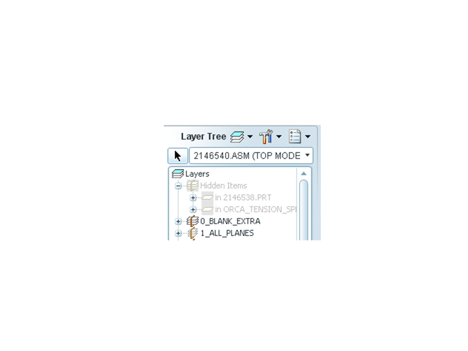

I want to set up a layer where all hidden components, be it a part or an assembly, reside. The reason I want to do this, is at the end of creating an assembly, I want to "unhide" everything I've hidden in order to get everything assembled. I don't want to have to seartch through the tree and drill through sub-assys to find the hidden culprits.

Your top level assembly model should automatically have a layer called Hidden Items which contains all objects that have ever been hidden.

I did now see that there is a hidden items rule, but I notice that you cannot right click->unhide with it.
But View->Visibility->Unhide All should do the trick!
April 17, 2012
You can right-click and Unhide from the Hidden items section of the layer menu provided you have the access rights to modify the object you're working on. If you have Pro/INTRALINK or Windchill, you have to have the model checked out or at least set to "continue" to be able to right-click and Unhide.

Create a Layer and right Click and hide what ever you want. You can do this in Dwg mode and hide Surfaces also.
