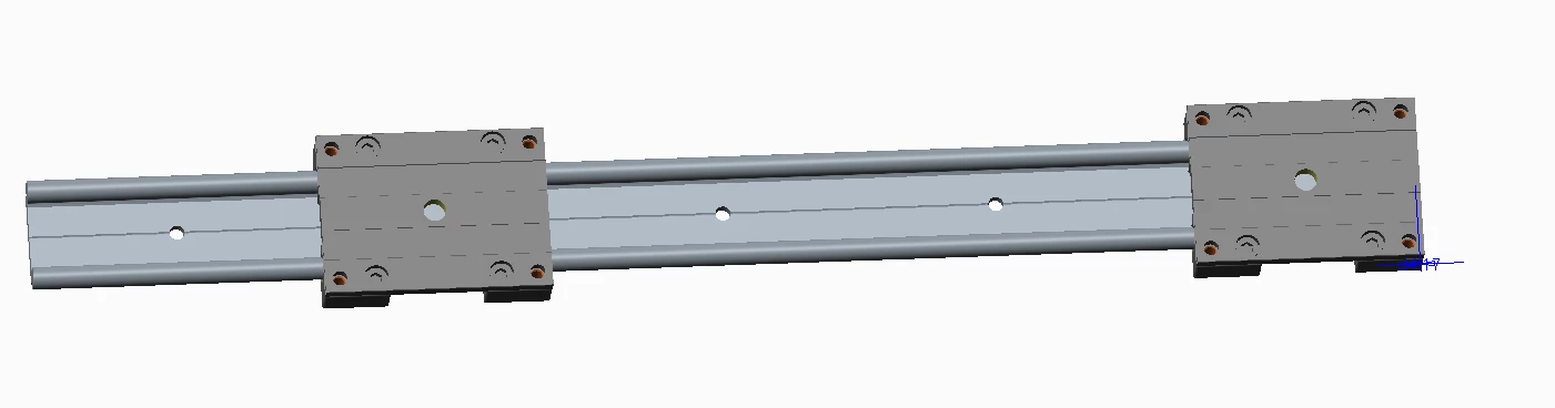

I have two sliders on the same rail and I have the left one defined as a slider mechanism powered by a servo motor and it works fine. When I move the left slider I want the right slider to move the same amount but in the opposite direction. I was trying to set up a relationship such that
left edge of rail to left slider = right edge of rail to right slider
And I was able to find the parameter for the right slider because it is defined as a distance from the right edge of the rail. However I have been unable to find a parameter for the left slider since it is defined as a slider mechanism. Anyone know how to create a distance reference that I can use or a way of doing this? Thanks.
Also a little more background, the sliders are being used for our scissor mechanism on our FRC robot this year. I'll attach some pictures to help understand what I'm trying to do, but basically the sliders need to move closer together and further apart equal amounts.
