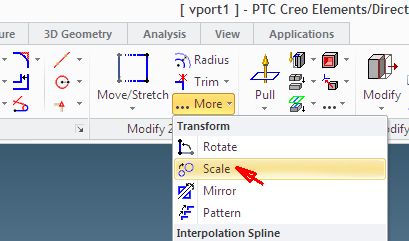

the answer to the last question is easy. See image 1
The rest is not so simple.

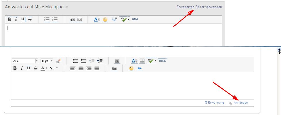

If you can not find the button for attachment of a file. picture 2
You have to use the advanced editor for the attachment of a file.
I used the German setting, but the buttons should be at the same place.
