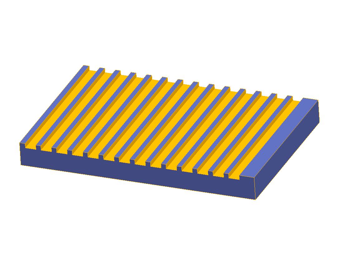

Don't want to beat a dead horse, but I want to make sure that you are aware that if you put lots of cuts through a surface, you can still pick that original surface with one pick and get all the leftover "mesas" between the cuts.
Maybe your situation is more complex, probably so.

Actually came up with a satisfactory solution myself, that does ALMOST what I was describing in allowing you to shade features. If you use the "Select Surfaces" dialog, then right-click and "Pick from List", it gives you the option to select an "Intent Surface", which picks the walls created by an individual feature. Combining that with the mentioned ability to pick all remaining surfaces AFTER cuts go through them let me work it out.
Thanks for the pointers, guys!
October 27, 2010
If you have something similar to what David showed above you can select the surfaces with 6 selections. Select the top surface and then hold the SHIFT key and select the 4 side surfaces. When you let go of the SHIFT key the slots and top surface should be selected. Hold the CTRL key and select the top surface and when you let go of the CTRL key only the slot surfaces should be selected. Called seed and boundary selection method.
