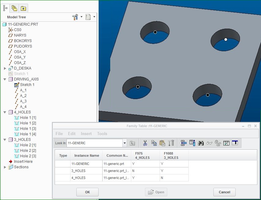

Manish,
pattern quantity has its own dimension symbol. If you show pattern dimensions using Edit command and put mouse cursor on pattern quantity value (eg. 4 EXTRUDES), then after a while you will see a floating box containing the name of pattern quantity symbol (eg. p10). You have to add this dimension into Family table column.
I attached simple model created on Creo Parametric 2.0.

Hey Martin ,
Thanks A lot ,finally i got the answer ,this is great...awesome
Manish

My solution is described on simply holes:
1. use pattern of datum axis like driving references. Make a pattern of 4 holes
2. place hole to this reference and make full reference pattern
3. place second hole to the same driving refernece. Press pattern and exclude holes that you don´t need. Click on black point and change it to white one.
4. make a family table, that include both HOLE PATTERNS and pick yes/no als you wish
