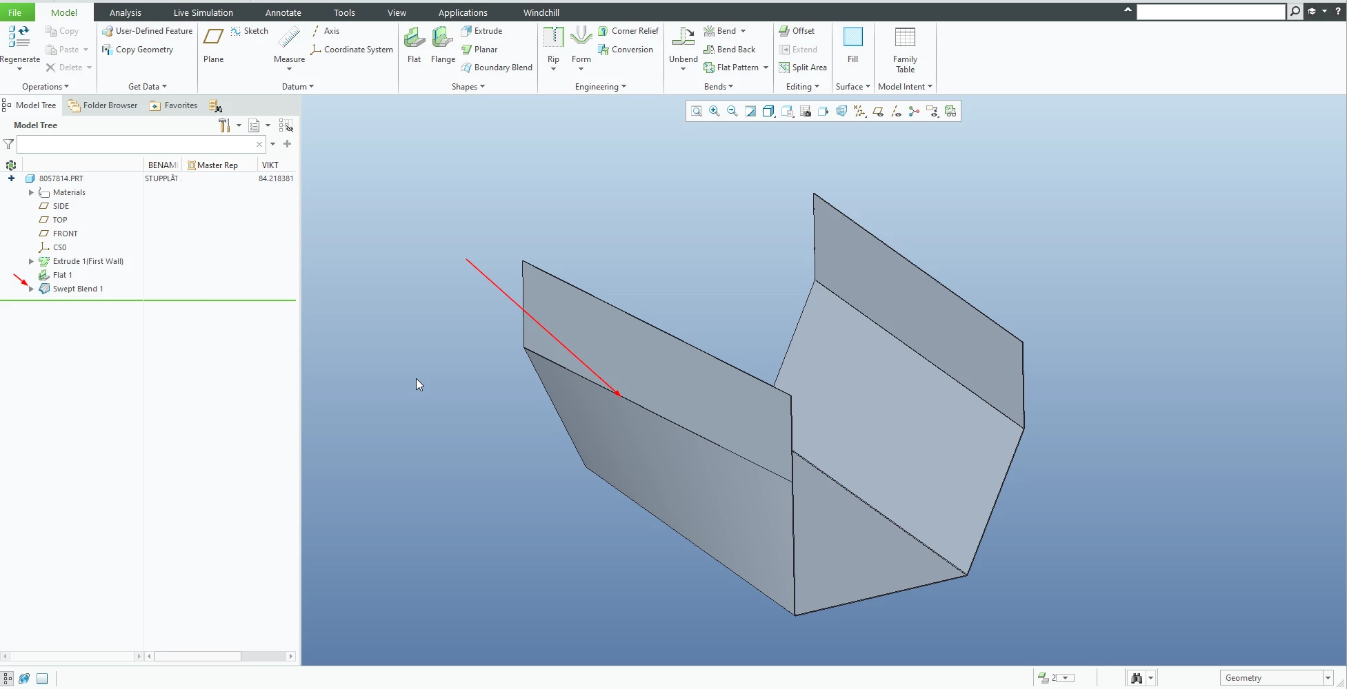

I am tring to unbend with swept blend, does anyone know where is the problem?
9 replies
tbraxton
Dec 11, 2023 3:07 PM UTC
Hard to tell from the picture but I suspect that the geometry of your swept blend is not a developable surface and therefore Creo will not flatten it in sheet metal. You can check this by looking at the Gaussian curvature analysis of the surface in question.

Thanks for the reply, but this shape of Swept blend (even that seems easy doesn't follow) the unbend (half of the shape unbended) the other not, even that i tried with sketched rip still the problem is there.

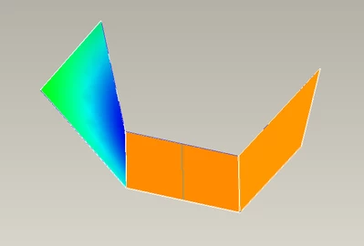

Use the Gaussian curvature analysis tool in Creo and post a screen shot of the surfaces in question with the Gaussian curvature displayed. It most likely will show you why you are not able to flatten this.

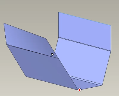

It really is impossible to diagnose based on the picture.
Based on what I see is there is a "twist" in the surface, but again, it's difficult to tell from just a picture.
My exagerrated image is below.
The curvature analysis tool that @tbraxton mentioned is under the analysis tab curvature.

It's definitely the "twist" you have in the part.
I do sheet metal sometimes and as this is, this is not something that can be done from the standpoint of how the sheet metal module works.
