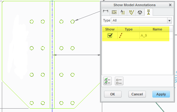

For the sheet metal drawings, when I make flat state view in the drawing, it is two lines at the bend. but for simple representation, i need to have only single bend line.
Best answer by AndyHermanson
7 replies
May 13, 2014

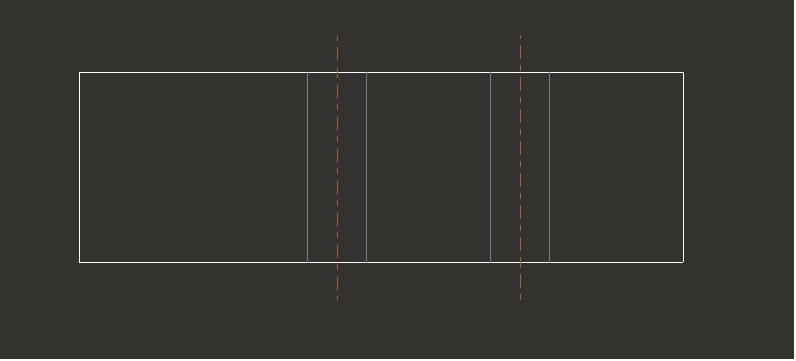

May 14, 2014
Thanks Andy & Stephen,
Extended reply please need your inputs... In the figure shown below... can it be possible to hide the lines and need to have the axis visible.
As you can see... I need to have only axis line... but the other lines which are light gray color... i wanna hide it.
May 14, 2014
double click the drawing view, click on view display option, and then select "none" under tangent edges display option.
