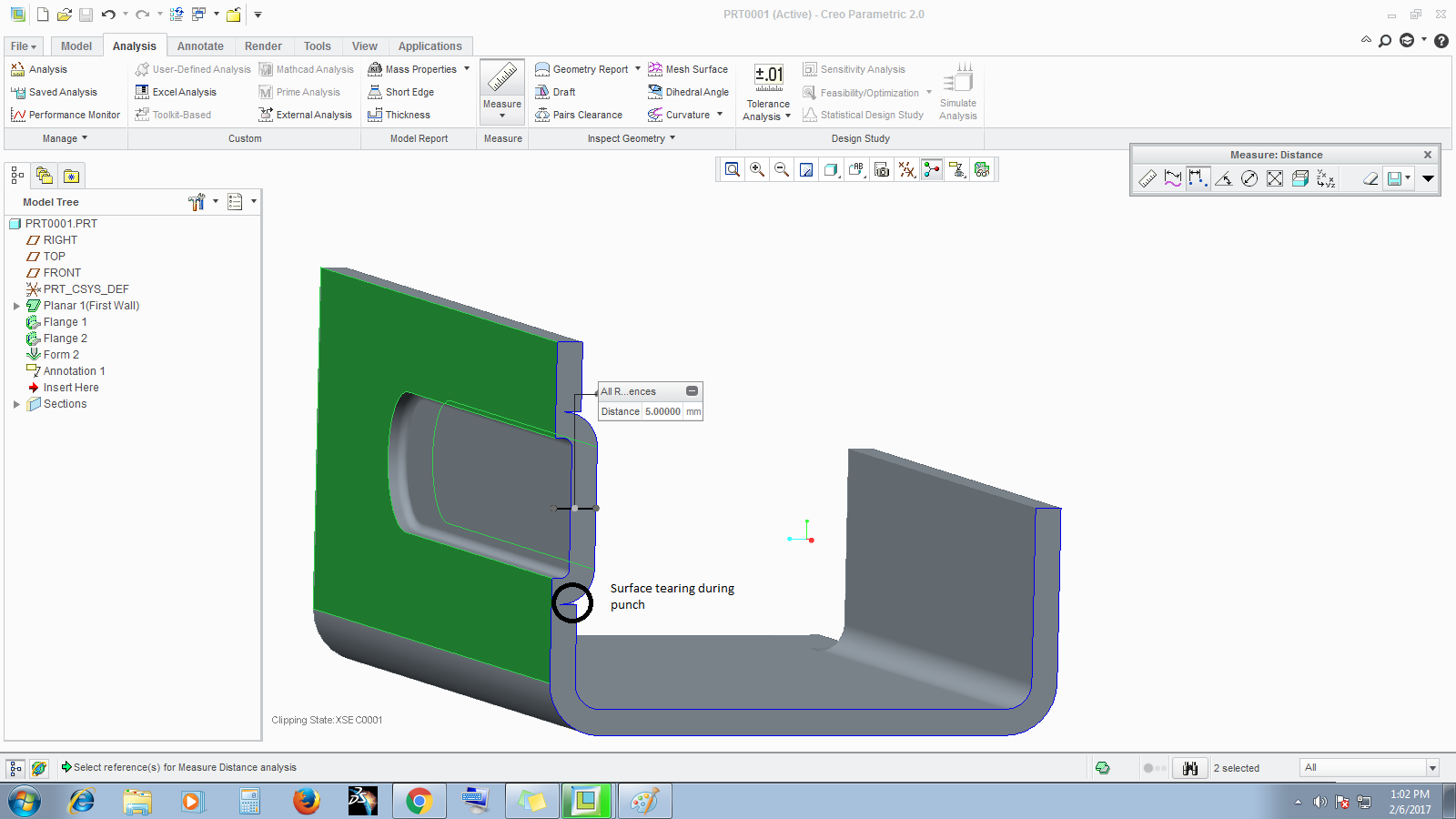

Hello guys,
I have a query regarding punch in creo sheet metal. If you see the pic I attached there is a surface tear it shouldn't happen. I know it has got to do with the punch tool radius but I can't get it done my constraint is that the total thickness of the SM should be 5mm after punching the radius dimensions doesn't matter( The base wall is 3mm).
I don't know what I am missing here. any help is deeply appreciated.
Thank you

I usually do by simple solid modeling eg. Extrude . It's simpler, faster and cleaner than sheet metal module.
Sheet metal module give me a lot of error and need attention to look at every features. I have to confirm that it take a right solution after I pressed regernated button.

I was able to correct my situation by changing one thing ATTAPON mentioned. I had previously created the curved geometry on my part using "flange". To fix it I simply used "extrude" instead and my flattened part appears correct now.
EDIT: Digging deeper, I suspect that my dev length dimension got changed to another value when I used "flange". When I changed it to the correct value, "flange" worked as well as "extrude". (So either way works correctly!)
To the original post, what about a solid model shelled out and then converted to sheet metal? Just an idea...
