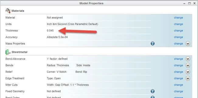

When creating the first wall of a sheet metal part is there a way to add a specific set of thicknesses into the drop down menu? Currently it just has 0.05 as a default. I would like 20ga (.039) as default and be able to pick 18, 16, 14 & 11 ga.
Creo Release 2, M110

You can set your default sheetmetal part thickness in your sheetmetal template part under File, Prepare, Model Properties. Not sure how to get the list you described or even if it's possible

Thanks Mike, that'll at least get the .039 (20ga) set as default.
