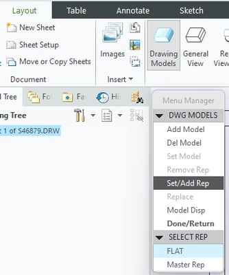

I think what you are missing is creating the needed simplified rep.
In the model, add an unbend and Bend back at the end of the model tree.
Create a Simplified Rep for the flat state with the Bend Back excluded.
In the drawing, select Drawing Models > Set/Add Rep and select your flat rep.  Now you can place a flattened view.

Mar 23, 2023 4:10 PM UTC
Mar 23, 2023 4:28 PM UTC
Hello kdirth,
thank you too for the quick feedback!
Its amazing - your way also works! 😀
I just tested it and its totally fine when you know what to choose...but I guess practice helps as always 😉 and you are right - there is always something new in creo.
