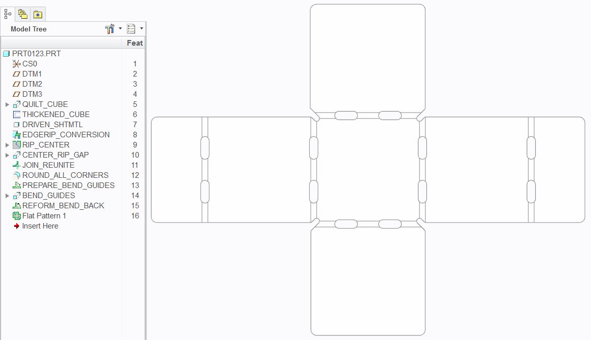

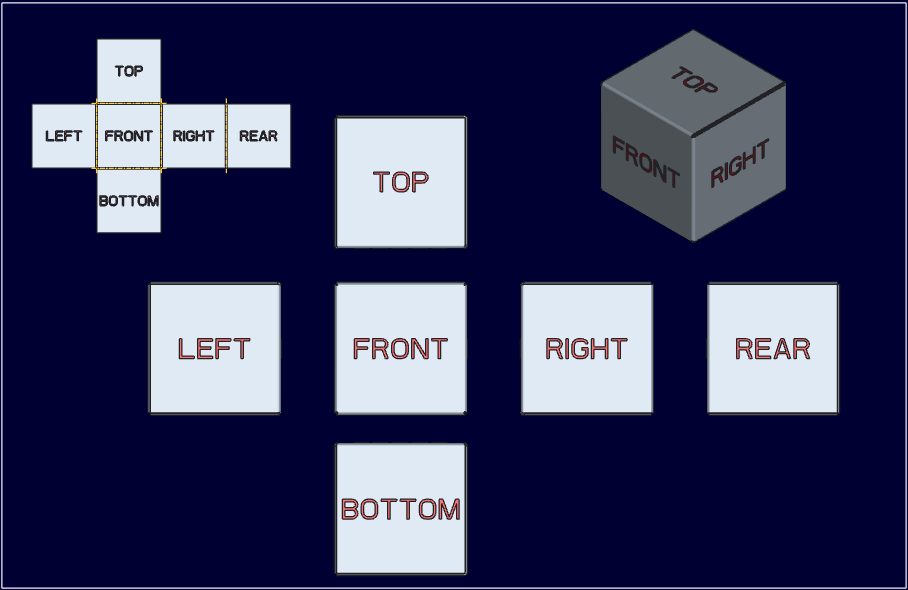

Then I tried to make the sheetmetal fold-out version of the 6 basic views by starting with a cube.  Here is where the fun begins.
Go ahead; start with a solid model of a cube and convert it to sheetmetal.
See what you can do with this challenge and post what you learned.
BTW: I use this as the default view creation model rather than using template models.
Edit: Since the original post was a tease, I figured I would update the post with more information.

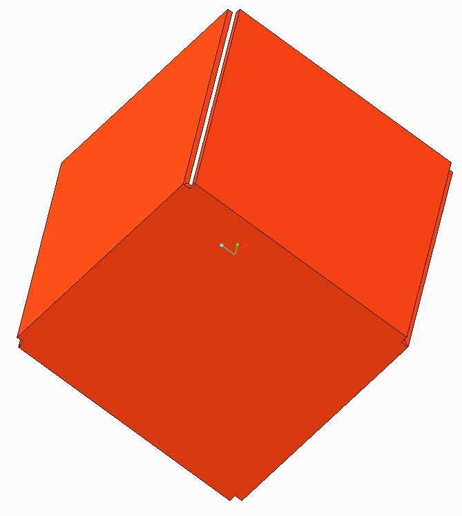

First of all, if you tried this, you might have noticed that a solid cube would simply flatten to the metal thickness when you define the sheetmetal conversion using the driven surface option, forcing you to use the shell option and loosing a complete wall.  This didn't set well with me so I used the technique in the video: create the cube using a thickened quilt.  Now the power of the conversion tool becomes apparent.  The conversion tool has two levels, which is not immediately apparent.  The rips can be treated individually and have a lot of power, many of which are particularly useful as it is difficult to re-create many of these when building a sheetmetal part from scratch.  Between the rips and corner relief's, both of which were deployed in the attached Creo 2.0 file, you have nearly no limitation with a little imagination.  The fact that you cannot create sketched rips inside the conversion tool had to be gotten around to divide the back wall down the middle.  I am not sure there was an option to accomplish this otherwise.  But the lesson learned here is that you must make a logical unfold part to get the corner relief's to work.  Again, corner reliefs are more controllable in this conversion feature than they are on their own or in wall/flange features.
The cube in the video is a bit more practical as you cannot form a closed cube.  The idea here is that this cube can be formed by hand (or at least with the use of a soft mallet).
Feel free to play with the model and change parameters.  As always, use the information provided as you will.

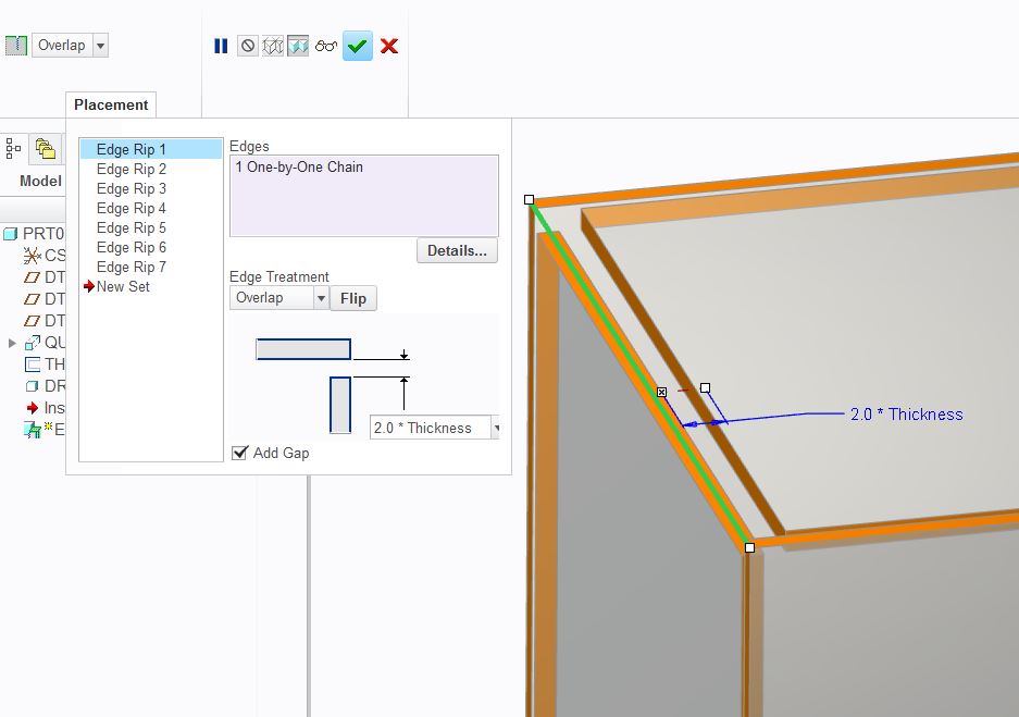

Thanks for the idea to try the other rip options.  I was sad to see you could not do a sketched rip in the conversion feature.
I also found a bug in the rip subfeature.  The overlap feature pulls back the wrong edge when you click the Add Gap option:

I also reported the bug to CS.  They already submitted it to engineering for review with SPR 2178730.  They will get back to me as to what will come of it.
May 15, 2013
I received word today from CS that the error is acknowledged by PTC engineering but they don't know if it can be fixed without causing errors elsewhere.  Fortunately there is a workaround option.  This is kind of disturbing though - paraphrased "We don't know if fixing the problem may cause more problems so no commitments to fixing this in the near future.".  How many other cases like this exist in the code?  Could this be why patterns have become so unstable?
