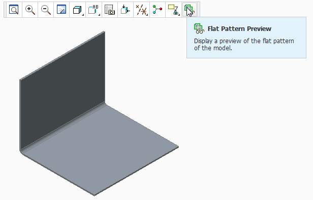

Look on the graphics window toolbar -- click on the "Flat Pattern Preview" icon:

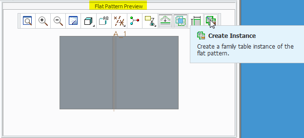

In the Flat Pattern Preview window, click on the "Create Instance" icon.
It will prompt for an instance name and create it.
I am guessing you had to jump to Creo 2 from Wildfire 4 without benefit of any training.  In my humble opinion, it's too big a jump without some training.  You have my sympathies if none was made available to you.  Good luck!
