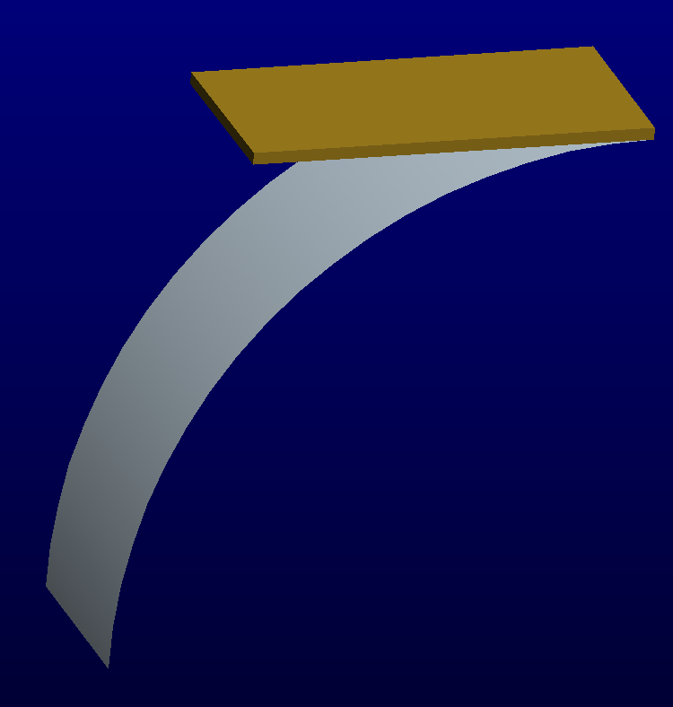

I have a model of a nameplate which is flat. However, I need to attach it to a curved surface.
I would like to modify the model so that I keep the flat part as the generic model and the curved as the model used in the assembly.
Can someone please advise the easiest way to perform this operation.

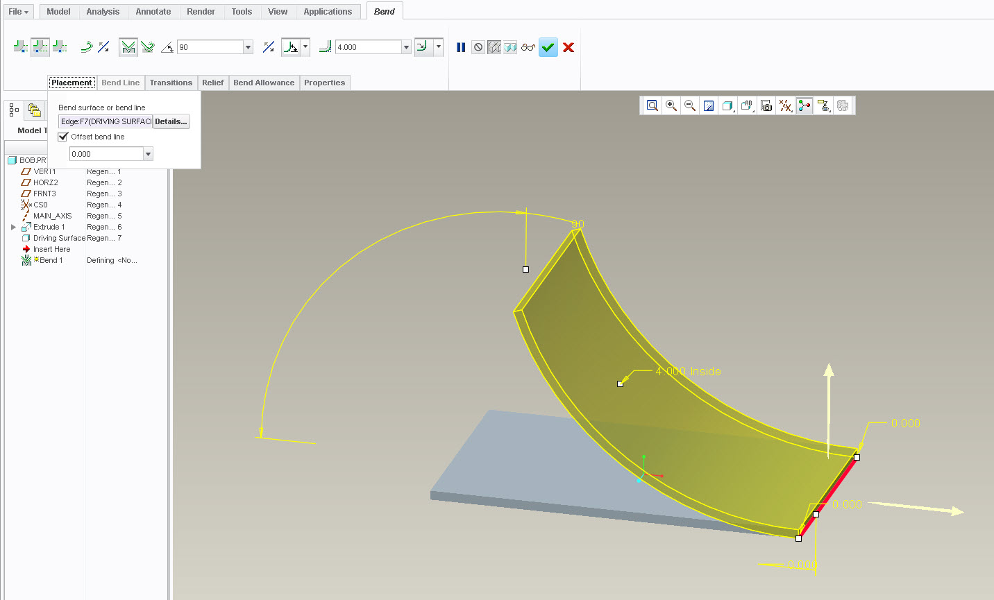

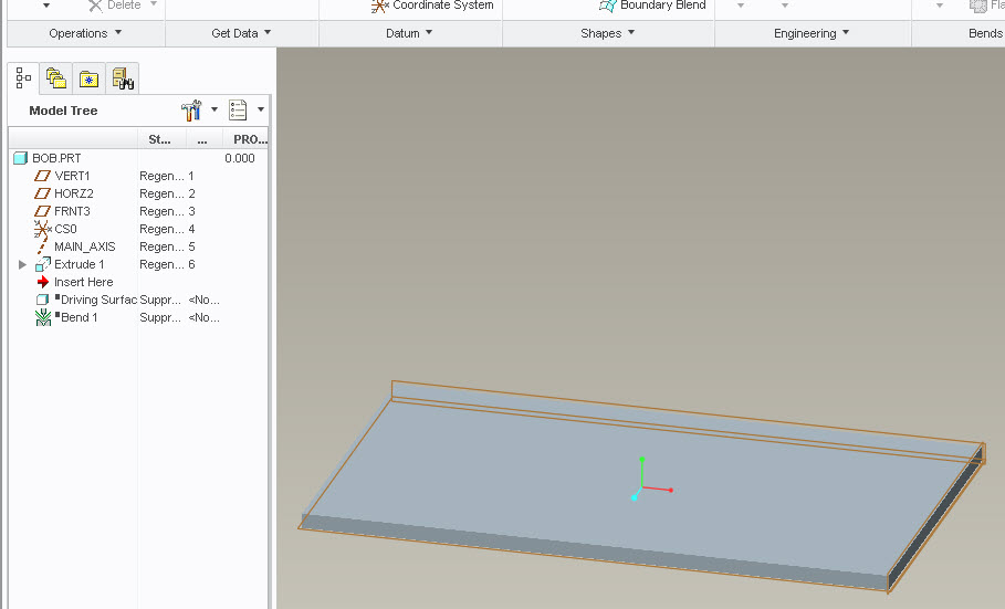

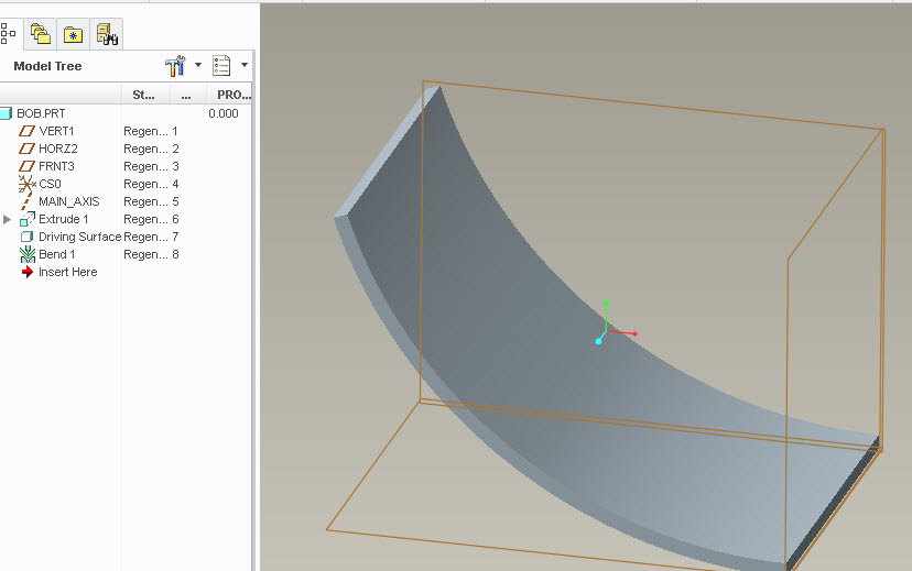

So what I did was build the extrude, converted it to sheet metal (driving surface) and then added a bend feature, selecting one of the end edges as the bend line, the bend radius would be change from thickness to whatever diameter you are wrapping the label on to. I used 90 degree angle but the part was too short to make it all the way to the end of the bend.

Something like this. I would like to wrap the gold coloured plate around the cylindrical surface.

I believe if you just convert it to sheetmetal, and add a bend feature to it you can get what you want. You can then control the bend feature with the family table.
