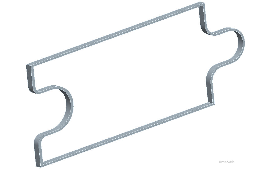

Can someone tell me if its possible to create a rolled sheetmetal part with an overlap. I have a cylindrical ring with interlocking features (see attached sketch), that I want to draw in sheet metal. The part will be lasercut from a piece of tubing and the manufacturer needs a flat geometery, I can't figure out how to create this part in sheet metal.

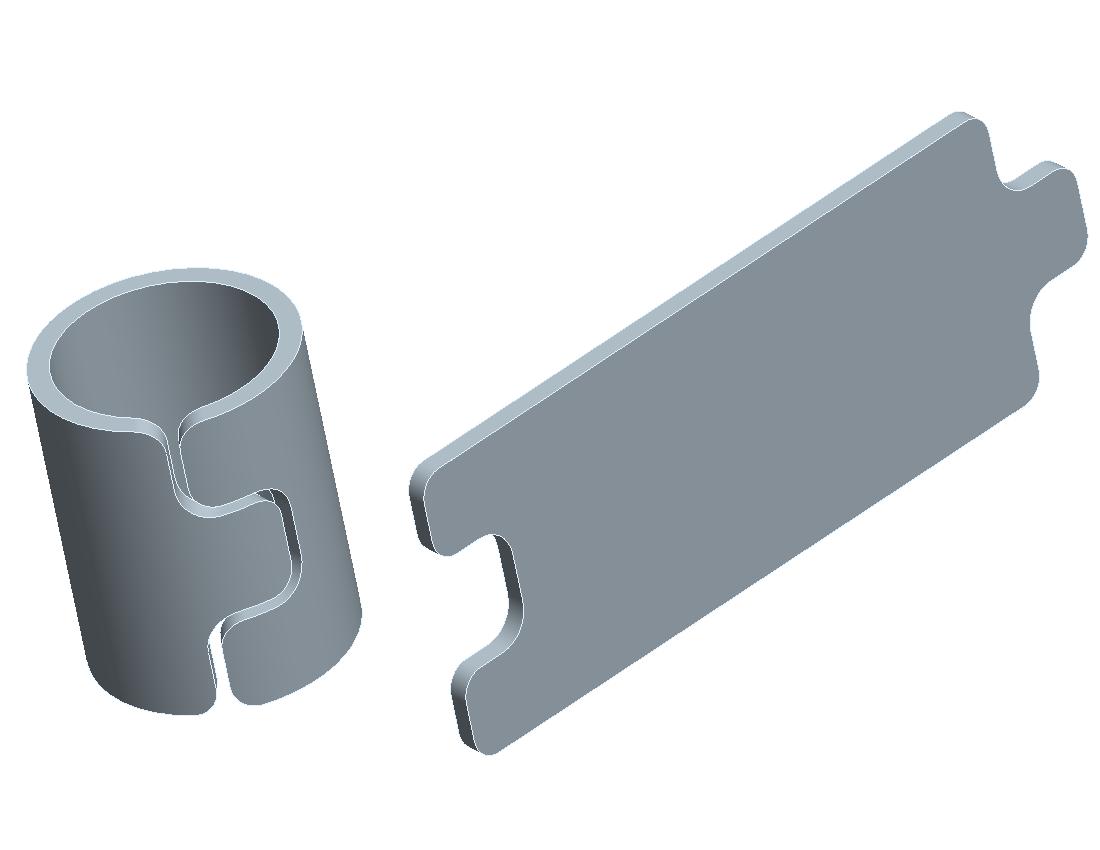

Mike,
I was wrong. It's been awhile and I forgot that you only need a straight edge, not a flat surface. Here's an example, part created in Standard mode, converted to Sheetmetal, then flattened.
David

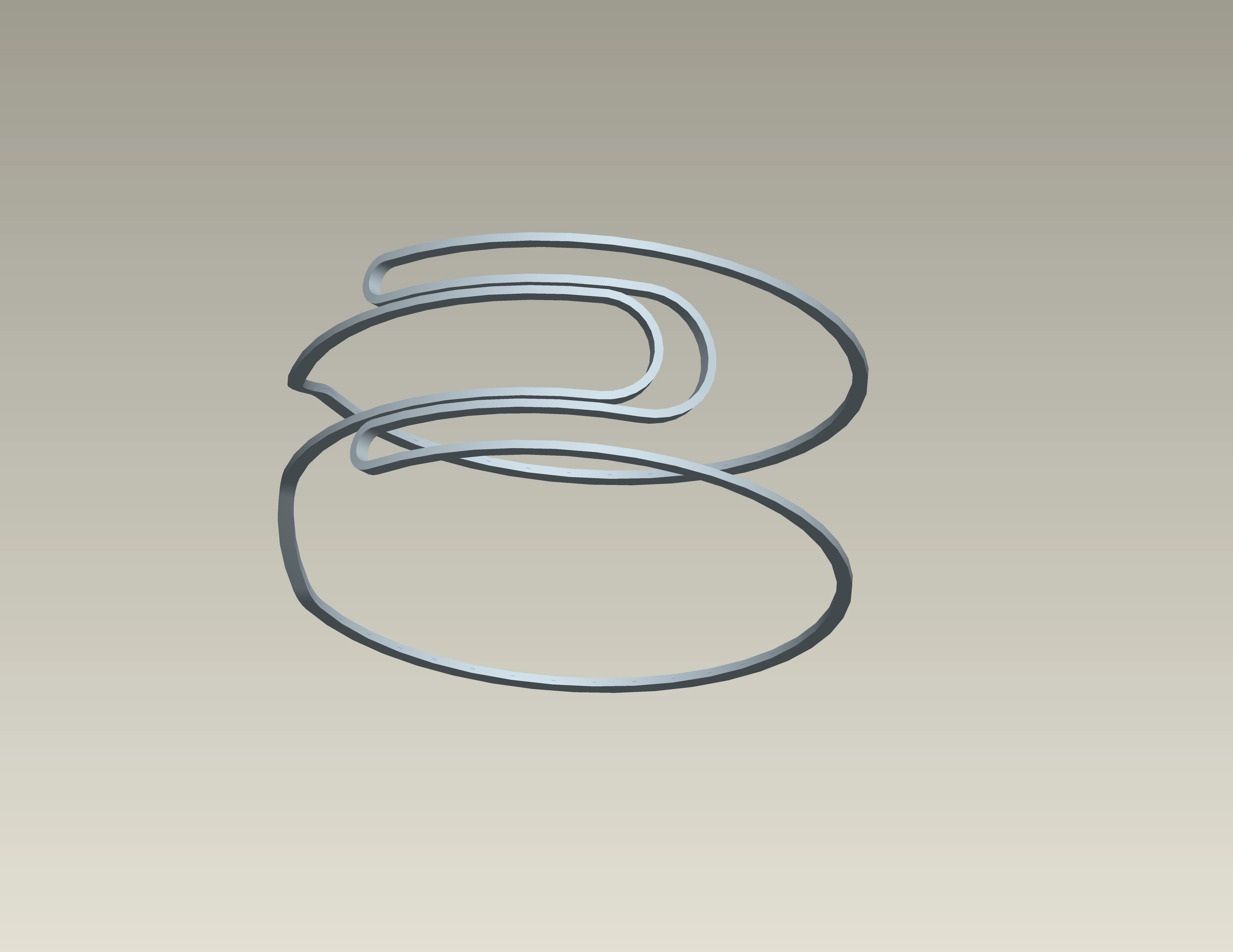

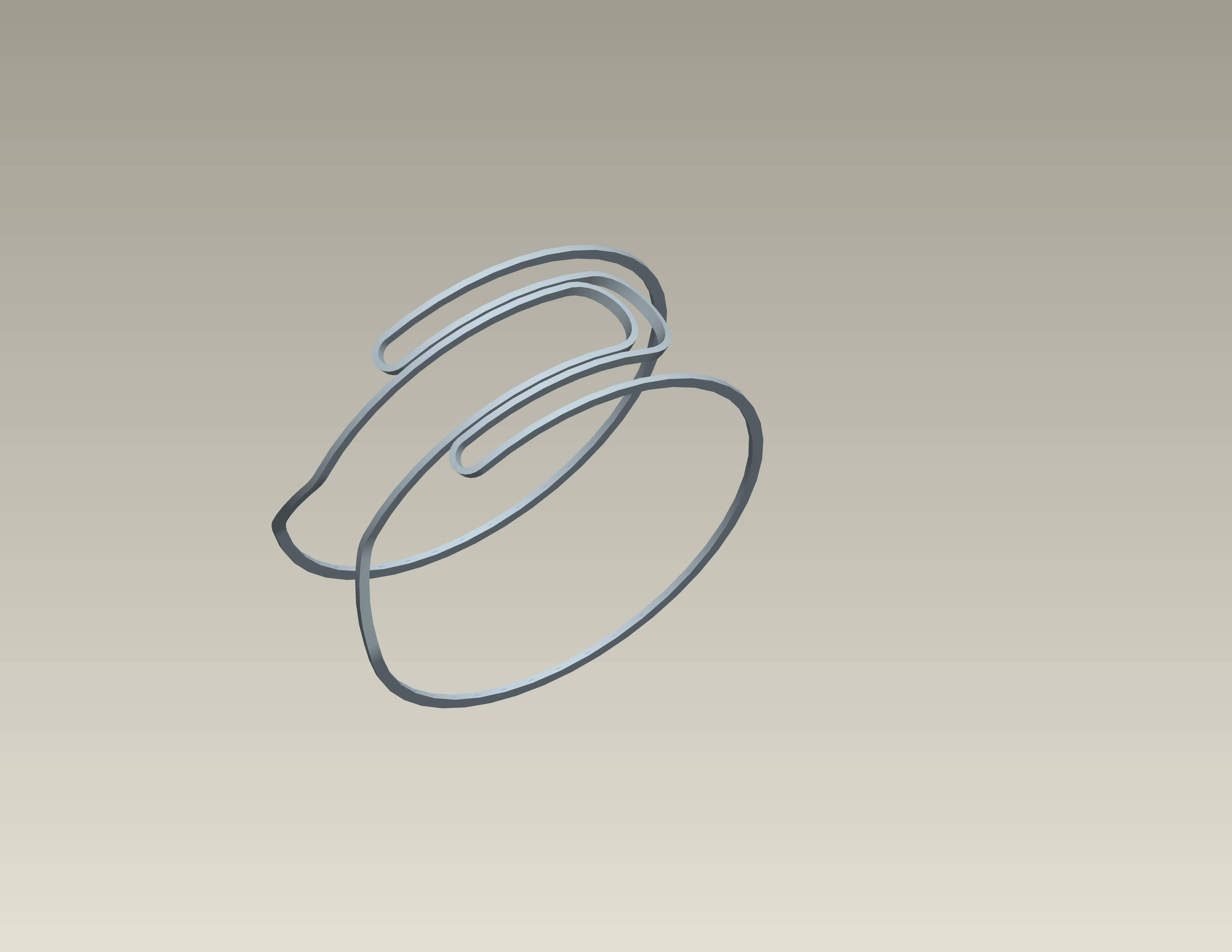

Thanks for the response. I created my original model as follows:
1. Sketch curve as flat geometery.
2. Swept protrusion of wire cross-section.
3. Spinal bend to roll the part.
The issue is that I want to create the model in the rolled configuration and then have PRO/E convert it to the flat. The actual model I'm creating is much more complex than this and it difficult to draw as a flat. How did you convert your above model into sheetmetal, what did you use as your driving surface?

Mike,
This also worked, and only a reference edge was necessary for the Unbend.
David
