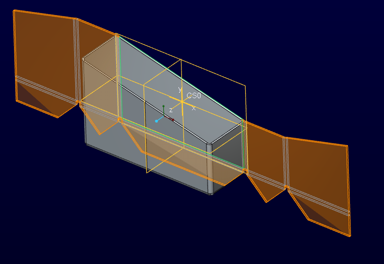

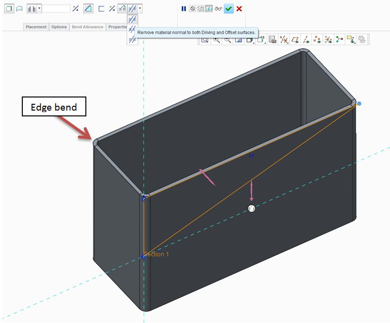

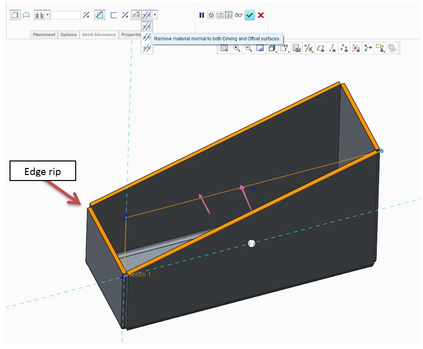

Im designing a frame using square tubes. Cut-outs that are not perpendicular to the metal wall are automatically adjusted in sheetmetal modus I would like to avoid unwanted edges sticking out, for this Creo has the "remove material normal to both driving and offset surfaces" function, but I cant get it to work!
It only works when the edges are ripped and not bend. See images. Am I doing something wrong or is this a bug or did they just stop programming when they needed the recources elsewhere?
Best answer by TomD.inPDX
If you make the surround 1st with a seam, the extrude does work properly. Then you build whatever you need for the "floor"

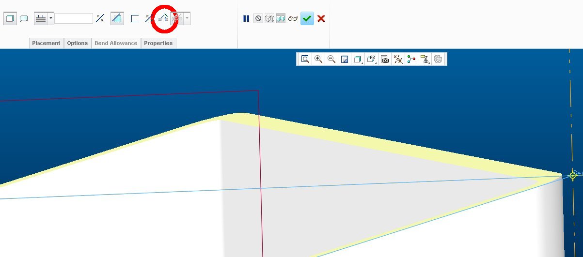

An square tube is not a sheet metal part. What you need to do in this case is to deactivate the "Remove material normal to surface" button.
