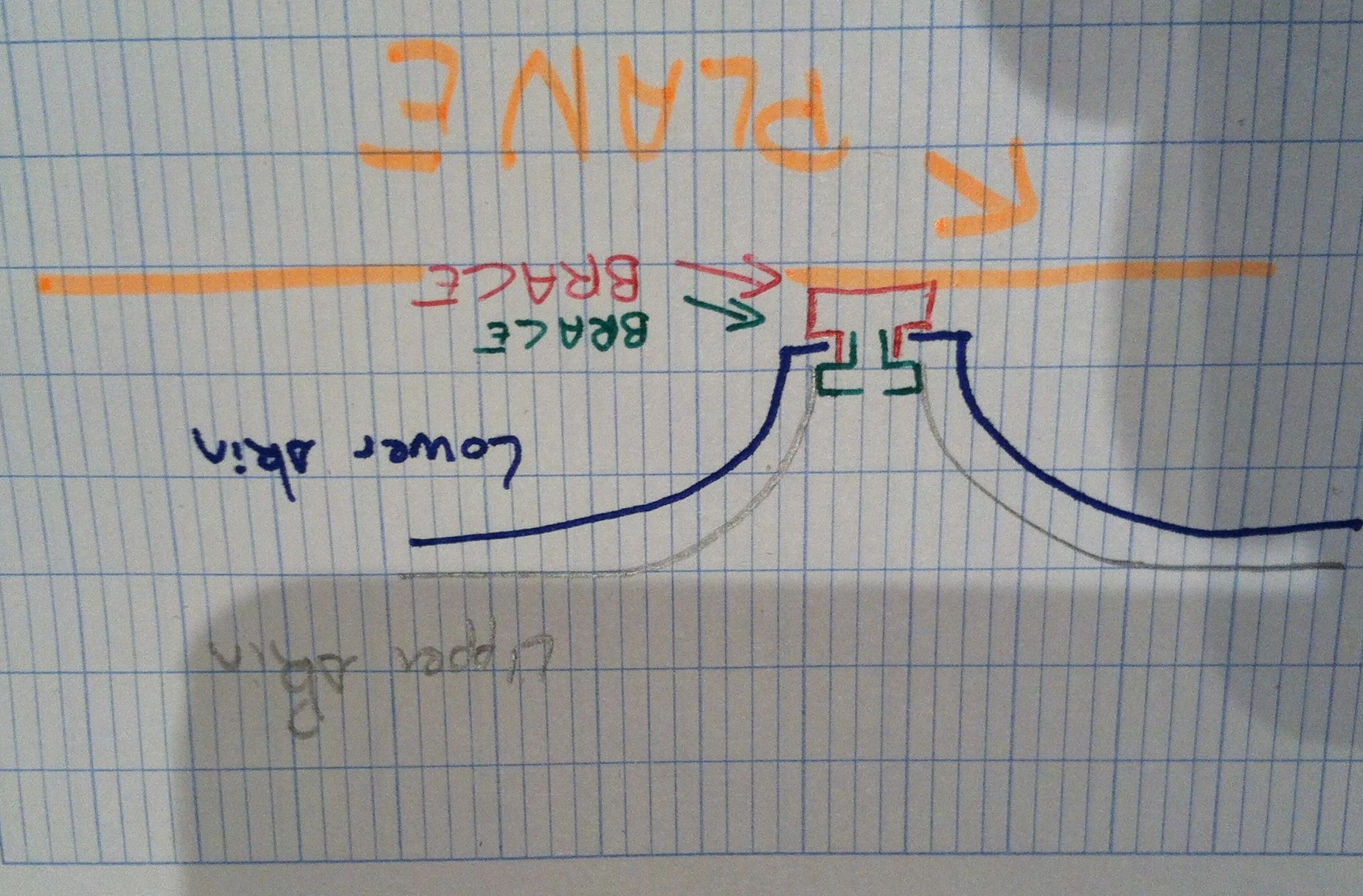

I need your help, because I would like to create a lower offset 10.2 mm from my upper "skin".
I created the shift of the surface without difficulty, but I can not properly shift the "holes".
I get discontinuities and overlaps.
Please find enclosed my ".asm"
PS : I havent create the brace/spacer.
Thank for your help.

Your surface features are probably easy enough to create. You can probably use the import model as a guide where you can make sections generate datum curves for use in a revolve sketch for the upper skin. Then you can offset this skin for the lower skin. Then add the remaining features to complete an enclosed quilt (merge the surfaces) and then you can solidify it. Maybe a little bit more work than you anticipated but it will make for a more robust model. If you can break all the references to the import model, all the better.

Marc, I was able to get your model. You cannot put holes in surfaces so you have to use the extrude feature with the remove material option. I also see a missing bottom in one of the 3 recesses. You can fill that with a "fill" feature and then use the Merge feature to join the fill feature to your import feature.

I have put two pictures to try to explain you what I like to do.
I think I'm missing the method to draw the hole of the lower skin. Can you help me to draw this hole ? ( I don't need to get the same dimension than the upper skin, but just something who looks like).
http://communities.ptc.com/photoAlbums/1705
The wall thickness and the sidewalls of the cone is 2 mm. (the real thickness will not be constant as it is a thermoplastic)
