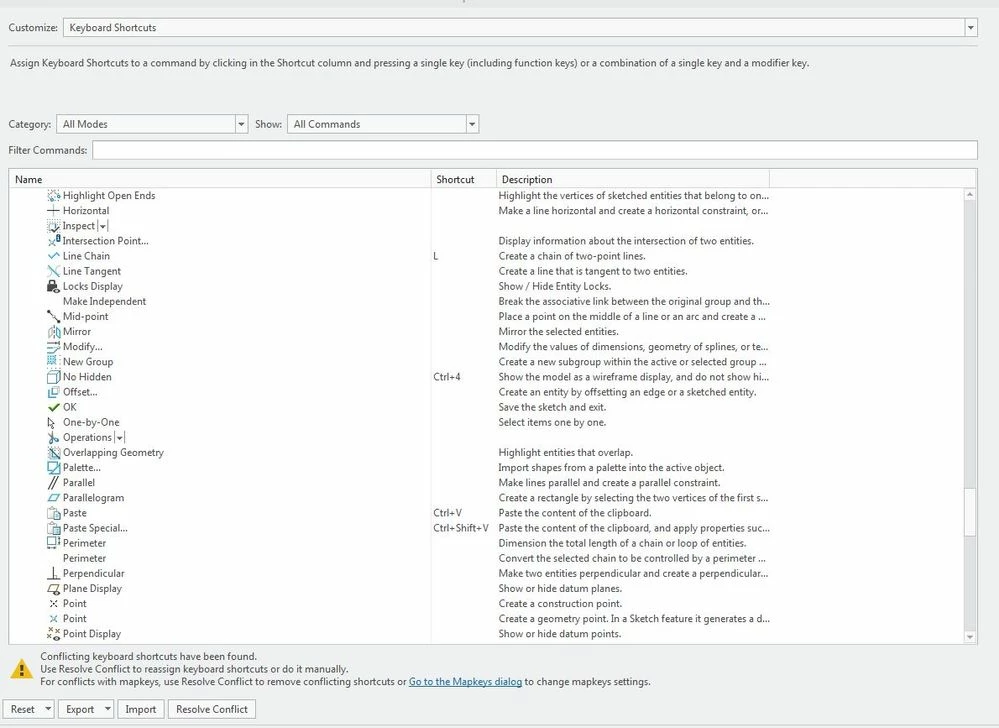

July 12, 2017
Thought you might be happy to know what you are asking for has become available in Creo 4.0 under an option called "keyboard shortcuts." L is already set to select the line chain command in sketcher mode.
