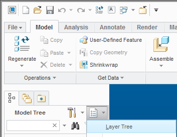

"I have also tried the model tree options as well but doesn't work."
Have you tried looking in the layer tree as well, to check if they aren't hidden there?
ygupta1-VisitorAuthor
May 18, 2015
I have checked, they are not hidden in the Layer tree.

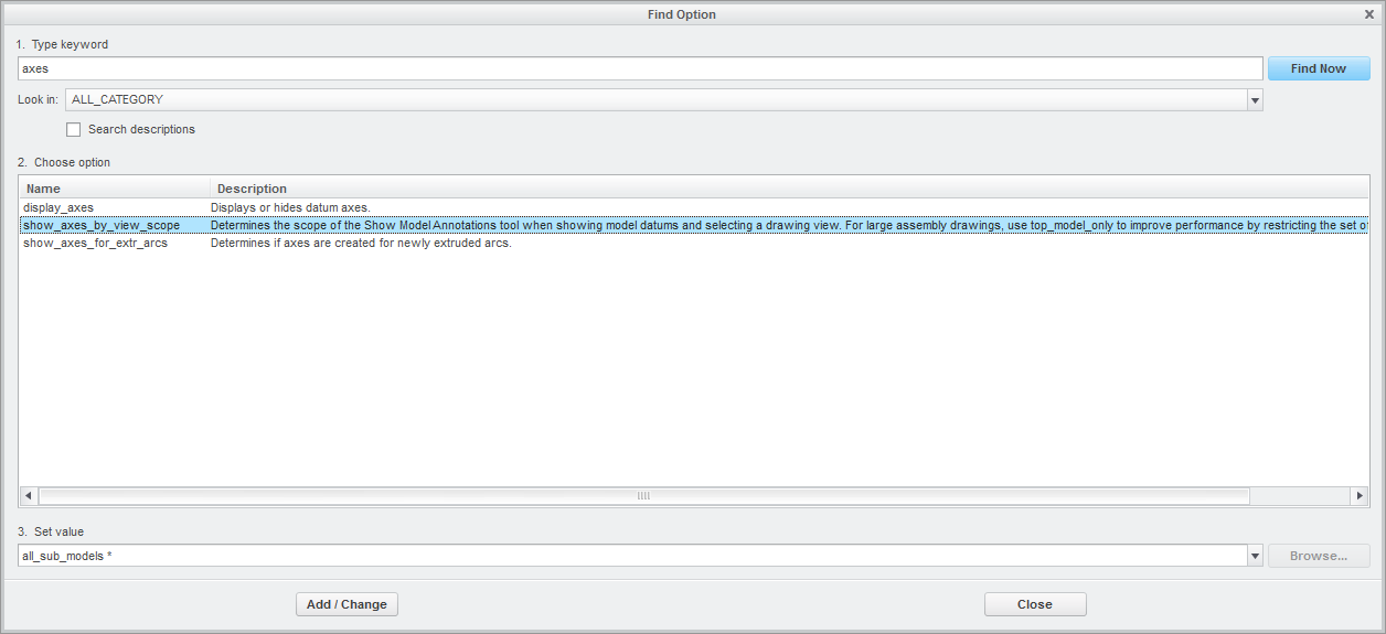

Not sure, but is this perhaps something to do with the configuration option show_axes_by_view_scope ?
May 18, 2015
Hi Paul
I did not find such option in configuration list. Can you please explain in detail ?
Yogesh
May 18, 2015
I'm using Creo 2.0.
Go to the menus: File->Options->Configuration Editor
You can quickly find options by using the "Find" command - e.g. I look for: axes
If in your system, this option is set for "top_model_only" then the sub-component axes will not be available for selection by the show/erase tool.
Try setting it to all_sub_models (which is the default) and see if your problem goes away...
