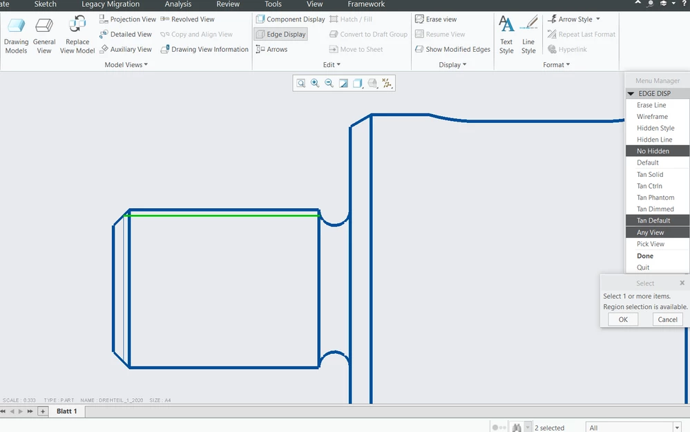

Hey guys, i am using PTC Creo Parametric 7.0 (Student Edition)
I created a thread on a pin.
Unfortunately, it does not really show the outlines (actually the inner lines) of the thread:
My visibility option is on "only show visible edges / lines"
If I select "show also not visible edges / lines", creo will show the whole thread but also everything else, which is not good for me.
Can somebody help me with this problem?

You can use Edge Display in the edit section to control the visibility of lines.
  • Select edge display
  • Select view settings for line
  • Select one or more lines (will highlight unshown lines as your curser passes over)
  • Select OK

What should i do now? I clicked on "Edge Display" and selected the hidden edge. But after pressing OK or Done, nothing changes.

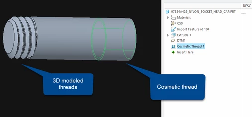

Is your part externally threaded or internally threaded? It's hard to tell from the screenshot. I would assume external based on the relief cut...???
How were the threads created? Are they actually modeled or did you use a cosmetic thread feature? If you used a cosmetic thread feature, you won't be able to see the threads. The cosmetic feature is just a surface. You'll be able to see the edges of the surfaces but nothing in the middle.
How it looks in 3D:

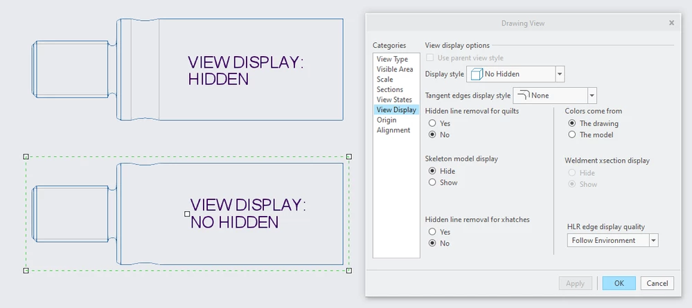

How it looks in 2D:
View display settings for the drawing view:
I tell my guys to avoid 3D threads whenever possible due to their affect on performance. We use cosmetic thread features in applications like these. To call it out on the drawing, we just use a manual leader note (not the best method but it's quick).

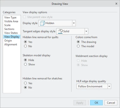

You need to change the drawing option setting 'hlr_for_threads' to 'NO'
