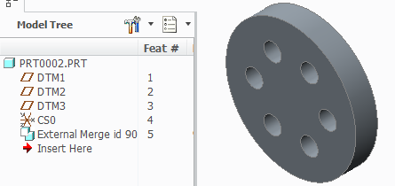

I'm currently working with Creo Parametric 2.0 M200.  In the past I know I was able to show a pattern dimension from a merged part on the drawing but I can't seem to remember how to do it. For example, I have a merged part like this:
On the drawing I can show the dimensions for the first hole in the pattern, but I can't show the pattern dimension of the angle between the holes (60° pink, created dimension below):

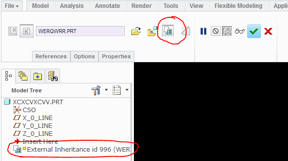

Best answer by manjunathrv
Yes. You are right. I use Creo 2.0 M180 and i have the same issue.
But there is a simple workaround. Follow these steps:
Change the external merge feature to Inheritance feature where you inherit all the features to the merge.
Then from the drawing model tree expand the External inheritance feature, select the pattern, RMB show dimensions by view:
You will now be able to show the 60 degree dimension. Once this is done you can revert back the Inheritance to External merge (toggle inheritance). You will be able to retain the dimension.
I tried this and it works
