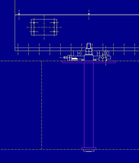

I have an anchor bolt that I want to show going through a foundation tube. The foundation tube is a shrinkwrap geometry shown for illustration purposes. My collegues are able to show this on thier drawings, but I can't seem to figure out just how they did it. Any ideas? First pic is of my drawing, second pic is how I want my drawing to look.

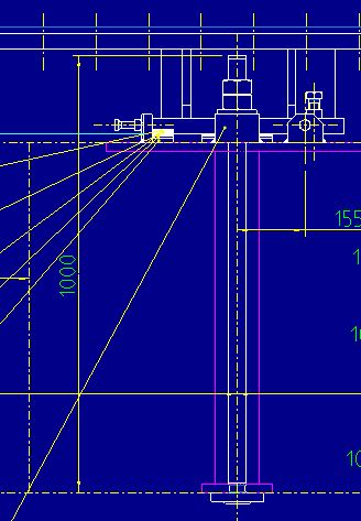

How I want the above picture to look like

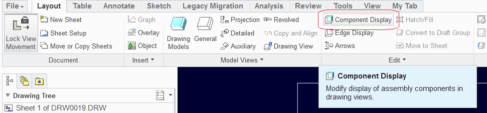

I think you can change the model display to transparent for selected parts in your drawing.
Edit, you can make a part phantom transparent. Are you sure they didn't section this this part?
September 2, 2014
I checked the part and there are no sections. Where can I change the model display to transparent at?
