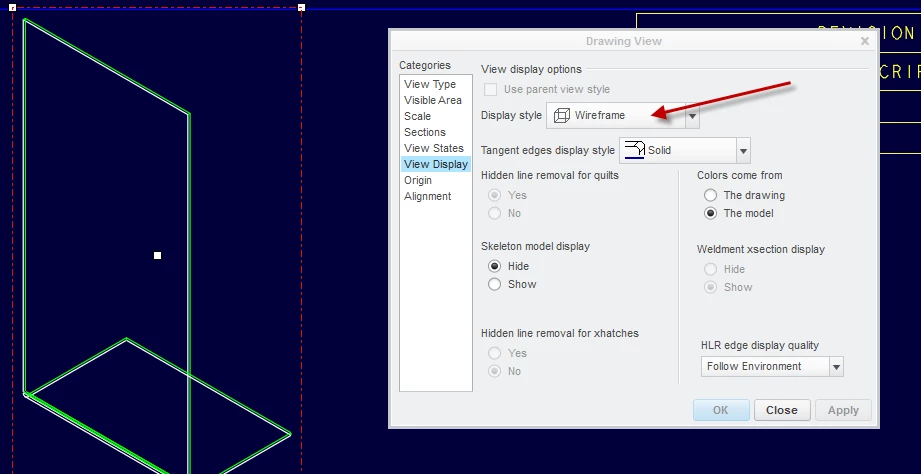

Here is what I figured out. Have to set the view display to wireframe to see the green/white side. My formed views now show the green/white side but the flat pattern still shows green on both sides.
[cid:image001.png@01D05D7A.CE656850]
Also in the system colors the driving surface has to be set (see below)
